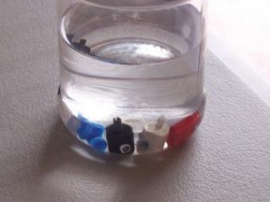

Store spray-can nozzles in a jar of thinner for a supply of clean nozzles that are ready to apply a perfect finish.
Spray-finish nozzles that refuse to spray, spray sideways, or spit and sputter cause frustration and can ruin a project.
To prevent this, I always remove the spray nozzle from the can and place it in a jar of appropriate thinner—usually lacquer thinner or paint thinner.
When you need the nozzle, take it out of the thinner and it’s perfectly clean. If you have a clogged nozzle, soak the nozzle in thinner.
You may need to use a sewing needle to pick out the softened finish. It’s not possible to save every nozzle, so when a can of finish is empty; I keep the nozzle as a backup. This works with spray-adhesive nozzles as well.
