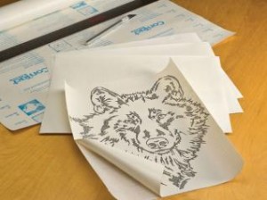

Instead of paying for expensive self-adhesive paper or 81/2″ by 11″ labels, I make my own from a roll of clear or white shelf liner paper.
I found a 17″ by 24′ roll of shelf liner at a national retailer for about $5. I cut the roll into fifty-two 81/2″ by 11″ sheets. This reduces my cost to about $0.10 per sheet.
If you cut carefully, you can run the sheets through an ordinary copier or printer like any other sheet of paper. Peel the shelf liner paper off of the backing paper and stick it onto your blank. Unlike commercially available labels, the shelf liner is easy to remove after you’ve cut the pattern.
