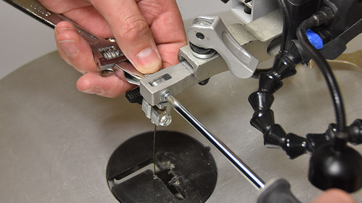

Blade-changing feature:
Nothing will take away from the fun, enjoyment and relaxation of the scroll saw than a saw that requires special tools to change the blade or change the blade tension. Have the salesperson show you how the blade is changed. Then you change the blade yourself. (The salesperson has probably changed the blade hundreds of times and can make it look easy.) If the salesperson takes out a special tool, run, don’t walk, away!

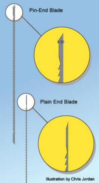

Blade types: There are two major kinds of scroll saw blades: pin-end and plain or flat-end. Pin-end blades have a pin at each end of the blade in order to hold it in place. Plain end blades are simply plain and require clamps to hold the end in place. If you really want to do true scrolling, do not purchase a pin-end saw, nor one that accepts both. The pin-end blades are much too large and cannot make sharp, delicate, interior cuts; most are not very high quality saws.
