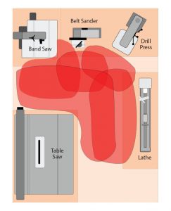

Space really is the final frontier—and no matter how big your workshop is, it never seems big enough. Even though most of the familiar methods of workshop planning and layout go out the window when applied to such a small space, I still needed to take into account the operating area around each machine and the space the material requires when being worked on. As I operate only one piece of equipment at a time, it made sense to overlap these workspaces when possible to squeeze in the machinery—a procedure that can optimize space in any size of workshop. The shaded areas in the illustration denote the operational space required for each machine. Overlapping these areas minimizes wasted space.
Although having the larger machines on casters does allow me to pull them to the center of the workshop to maximize their use, I still wanted to operate them in situ for the smaller tasks. A few hours spent with graph paper and sketches revealed a) which little-used machines would need to be stored under the bench to be brought out when required, b) how often and for which tasks the machines would need to be moved, and c) how much operating space I could reasonably overlap. This exercise indicated how best to organize my original layout and how compact it could be without compromising safety and efficiency. After an initial game of musical chairs during its design, my layout has changed little over the years.

Internal Dimensions: • Width: 5′ 11″ • Length: 7′ 103/4″ • Height: 7′ 4″ • Footprint: 46.7 sq. ft.
• Volume : 342.6 cu. ft.

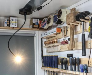

Having a designated place for everything is a great advantage in a small space. Everything apart from the bench that the drill press sits on is either on castors or hung on the walls using a French cleat system. Custom hangers for each tool mean that not an inch is wasted. There are no cupboards or drawers to collect junk and, as the cleats cover all of the wall space, the entire workshop can be rearranged at will. Even the roof space is used for storage. Two DIY roof-mounted gantries accommodate homemade camera and microphone booms, and with metal plates and power sockets for lighting up there too, I have the ability to move my magnetic work lights wherever they are needed. Tripping over tripods during filming is something I don’t miss at all.

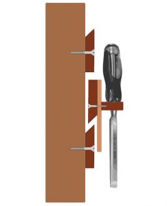

The French cleat is a method of hanging anything—from a piece of artwork to fully laden kitchen cabinets—with ease. Just use a 45° angle on the mating surfaces, and the weight of the hanging object holds it securely against the wall. French cleats provide an added feature of total flexibility, meaning that the hanging items can easily be repositioned elsewhere on another cleat. The cleats themselves only intrude into the workspace by the thickness of the wood used (in my case 7/8″ [2.2cm] pine) and therefore stay out of the way when not in use. The workshop cleats cover three walls, so anything can be relocated depending on my changing needs.
When gathering materials for a French cleat system, keep in mind that pine, hardwood, or plywood from 3/4″ (1.9cm) up is fine for the rails and hangers. However, I would avoid composite boards such as MDF or particle board, as these can give out without warning. Use multiple anchor points for each length into either brick wall or wooden studs. Once you have the first cleat in place and level at the lowest point on the wall fitting, the rest is easy. With the use of temporary spacers, the remaining rails can be equally spaced with accuracy as you work upward. Rows of cleats close together will maximize the usable space, but remember to allow a little extra clearance between cleat rails for the hanging cleat to drop into place. Spacing them evenly will allow you to use more than one cleat for large or heavy items without compromising mobility. My cleat rails are 2 1/2″ (6.4cm) and spaced 3 1/4″ (8.3cm) apart, but larger workshops may not necessarily require such a density.

When reaching for a tool, I want to be able to grab it without having to move other things out of the way first. It slows down workflow and leads to untidy clutter, as items not related to the task are often moved and not immediately put back where they belong. Disorganization soon escalates into an untidy, frustrating, and inefficient mess.

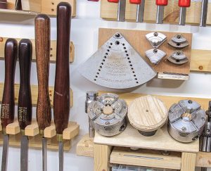

As floorspace is a premium, I hang everything on the walls and put it back immediately after use. Tools are organized around the area they are used the most, with the least-used tools hung out of the way. For example, all the wood turning tools, chucks, abrasives, and finishes are located within easy reach of the lathe. Planes, saws, gauges, and other hand tools sit near the workbench. Drill bits, Forstner bits, chuck keys, and lubrication oil are placed around the drill press. You always know where every item is, and once you are familiar with the layout, you can reach for a tool without moving and know exactly where it is without even looking!
Should I use a tool in more than one place, it gets placed in a spot where I can reach for it from either position. The pockets of my working trousers always contain pencils and a tape measure, so I know where they are at all times. This may appear to be a little over-the-top, but consider all those wasted minutes spent looking for a tool. They can soon add up!
Hangers and Caddies

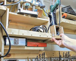

When it comes to storage strategies, your imagination is your only limiting factor. My design rule is that the tool must be accessible and reachable with just one hand. Hangers and caddies are utility items, designed to do a job and not necessarily for show—so anything goes. For an individual tool hanger, I customize the method of hanging depending on the shape of the tool. When a tool already has a method of hanging, I take advantage of it. Drawing the shape of the hand hole and cutting it out of the appropriate wood using a scroll saw couldn’t be easier to get saws hanging just right—teeth hanging inward, of course!
Caddies are built to suit the tool and its accessories. Most are variations of a box section that is simply screwed together so that it can be easily disassembled, modified, or reused to accommodate new accessories. I find 1/2″ (1.3cm) plywood to be quite adequate for these caddies. I would imagine that, like me, you may have a few offcuts of the stuff already!

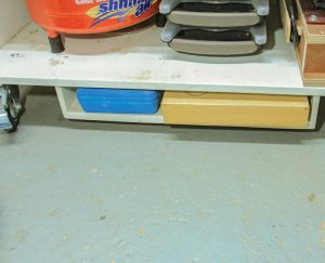

Areas can have more than one use. Turning the lathe bed into an additional workspace with a clip-on panel when it’s not in use can be handy for larger projects.
The floor is not for storage. Pushing something out of the way under a bench will restrict that bench from being moved, but mounting additional storage between the casters will allow the space to be utilized and will move with the bench.

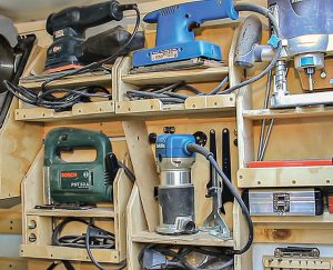

In the 8×6, power tools are stored in custom lift-down caddies so all their essential accessories are kept with them. The caddies, which also store the power flex, are simple to make, and you can easily modify them on the fly should the need arise. If I have to work outside or off-site, I can easily grab the caddy and go—knowing I have all the bits and pieces required for that tool. These caddies are more accessible and space-efficient than the original storage cases. In normal circumstances, when a power tool is in use, its case lies around, usually left open to collect shavings (come on, admit it). But in my shop, the caddy goes back on the wall and out of the way.
To keep batteries from rolling around or getting lost, I situate them near the tools they are used with and rechargeable cells are placed backward as a visual reminder that they are in need of an overnight recharge. This simple hack saves a small fortune from going into the swear box!

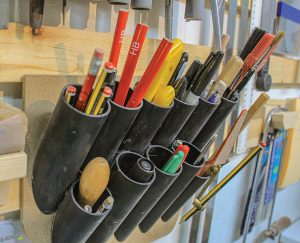

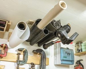

Saws would take up a great deal more space if conventionally stored flat to the wall; however, hanging them sideways saves valuable wall space. Some PVC pipe and hot glue allow compact storage for pliers, grips, and other hand tools.

When building tool storage areas, I often use up offcuts of PVC or ABS pipe, as it’s a ready-made resource. I either buy it cheap, dumpster-dive (always seek permission first), or ask local tradespeople for offcuts. Overflow pipe around 3/4″ (1.9cm) works great for collecting small tools, and rainwater downpipe works well for larger individual tools.
My glue gun caddy accommodates both the glue sticks and the power cable, and the short length of 3″ (7.6cm) PVC downpipe holds the gun so that it can be safely stowed straight after use while still hot! The pipes are hot glued together and to the cleat hanger, which offers enough strength for the job but lets me pull them apart for rearrangement at a later date. If I find I need another holder, I simply cut a piece of pipe to the required length and, after a test fit with the tool, glue it onto the existing arrangement.

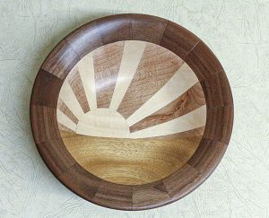

Sunrise Bowl.

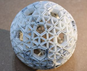

Geodesic Sphere.

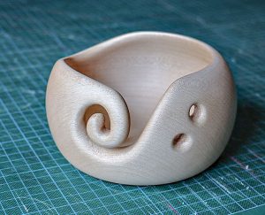

Yarn Bowl.

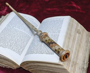

Wizard Wand.
