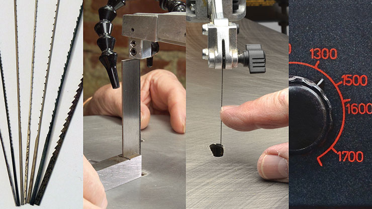

Blade Tension
Before inserting a blade, the tension should be completely removed. Clamp both ends of the blade into the blade holders and adjust the tension. Push on the blade with your finger. It should flex no more than 1/8″ forward, backward, or side to side.
A blade that does not have enough tension will wander. It will also flex from side to side, making for irregular or angled cuts. If you press too hard on a loose blade, it will usually snap.
A blade that has too much tension is more susceptible to breaking and tends to pull out of the blade holders. In general, it is better to make the blade too tight rather than too loose.

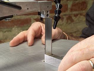

scroll-saw-basics3Squaring Your Table
Most scroll saws have an adjustable table that allow you to make cuts at different angles. There are times when you want your saw set at an angle, but most cutting is done with the blade perpendicular to the table. If the table is even slightly off-square, your cuts will be angled. This interferes with puzzle pieces, intarsia, segmentation, and many other scrolling projects.
The most common method for squaring your table is the small square method. Set the square flat on the saw table against a blade that has been inserted and tensioned. Adjust the table to form a 90°-angle to the blade. scroll-saw-basics4
