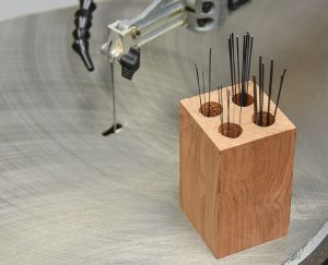

Transform a chunk of scrap wood into a custom blade holder. Measure in 1/2″ (1.3cm) from the edge on all four sides. Buy inexpensive rare earth magnets around 1/2″ (1.3cm) in diameter (the size doesn’t really matter). Choose a Forstner bit slightly larger than the rare earth magnets. Center the bit where the lines intersect and drill down to within 1/4″ (6mm) of the bottom. Apply a little glue to the bottom of each magnet and insert them into the holes.

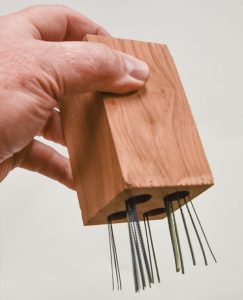

The magnets hold scroll saw blades securely enough to keep them from flying everywhere if you knock the holder over. They are usually strong enough to secure the holder to a metal surface; I put my holder sideways on a metal filing cabinet near my saw. After making your blade holder, start scrolling your next project with this spring-inspired floral trivet.
The magnetized base holds fast to any metal surface, even the saw itself.
This simple blade holder is virtually spill-proof and lets you sort blades by size or type.
