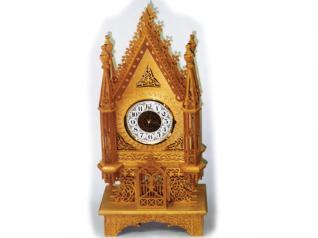

Chances are, the first time you saw a fretwork piece, your first thought was, “Wow.” And the second was “I could never do that.” That’s where you’re wrong, my friend. With just a few pointers and patience, you can scroll even the most complex fretwork design.
