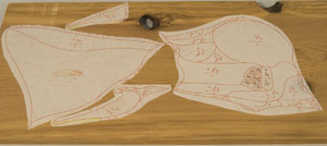

JudyGaleRoberts1Q. What is the best way to transfer the pattern to the different shades of wood?
A. When I first started creating intarsia with my dad back in the 1970s we used carbon paper to trace each part onto the different shades of wood. This is a viable method, especially if you have a very large project. In the last ten years, the technique has changed. I use multiple copies of the pattern. Most projects will use around five copies. I cut each part that has a different color or grain direction from the patterns. I like to leave at least ¼” of excess paper around each pattern piece. This gives the pattern a little more staying power as you cut the parts.
