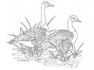

To transform a line or shaded pattern into a series of planes, or shapes suitable for scrolling, it is best to think in terms of distinctive masses within the picture. These can come in two forms: 1) distinct independent elements, such as body parts and physical items that make up the background, or 2) sections distinguished by a change of color, fur texture and direction, and feather groupings.
In the case of LAKESIDE VIEW (see Figure 1), an example of a distinct independent element would be a single reed or a ripple of water. An example of a change in feather groupings can be found in various locations on the birds’ backs where the upper back feathers merge into lower back feathers and continue to step down into the tail feathers.
Color distinctions such as the white facial markings can also be found and segmented off to further define the subject and add to the overall picture design. Once these distinctions are recognized, breaking down a pattern into a basic segmented image is not an overly difficult task.

Freestyle planes follow or outline distinct divisions and groups in a pattern, like body parts or feather groups or background elements. The shapes of the segments are determined by the shapes you are outlining; therefore, they are random in form and follow no standard geometric shape. Figure 2 shows a segmented freestyle plane pattern.
Geometric Plane Patterns
Geometric plane patterns are designed using standard geometric forms—think of triangles for chip carving—to define body parts, feather groups, and other distinct areas of the pattern. Figure 3 shows a segmented geometric plane pattern.
Figure 2 Freestyle Plane Pattern Figure 3 Geometric Plane Pattern
Freestyle Geometric
To adapt the original pattern for scrolling, bridgework becomes more important. These joining pieces are functional and keep the finished pieces from falling apart.
