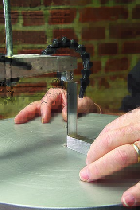

The most common method for squaring a table uses a small metal square, or right-angle tool. Set the square flat on the saw table against a blade that has been inserted and tensioned. Adjust the table to form a 90° angle to the blade.

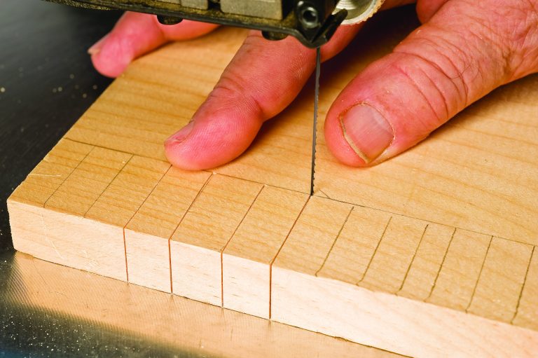

You can also use the kerf-test method. Take a 1-3/4″ (4.4cm)-thick piece of scrap wood and cut about 1⁄2″ (1.3cm) into it. Stop the saw, back the blade out, and spin the wood around to the back of the blade. If the blade slips easily into the kerf, the table is square. If it doesn’t slide into the kerf, adjust the table and perform the test again until the blade slips in easily.

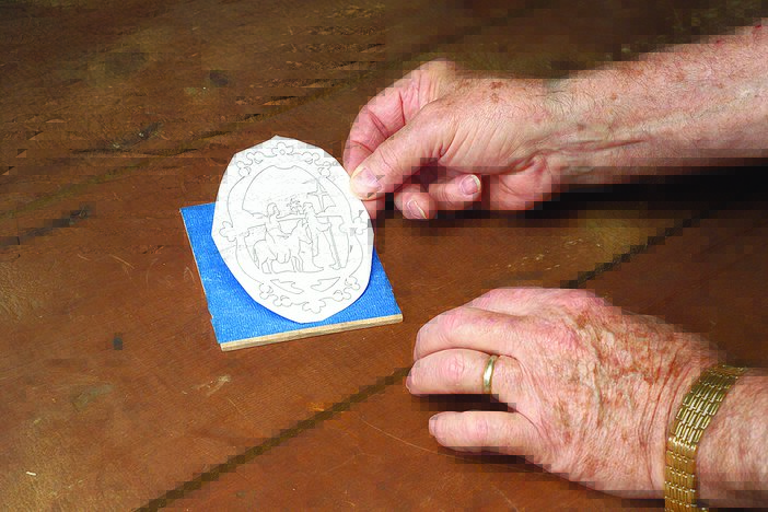

Attaching Patterns

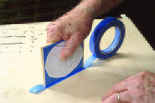

Temporary-bond spray adhesive is the most common method used to attach patterns to stock. Cover the wood blank with blue painter’s tape to lubricate the blade and make the pattern easier to remove. Photocopy the pattern. Spray the adhesive on the back of the copy of the pattern, wait a few seconds, and then press the pattern onto the taped blank. Rubber cement or glue sticks work similarly.

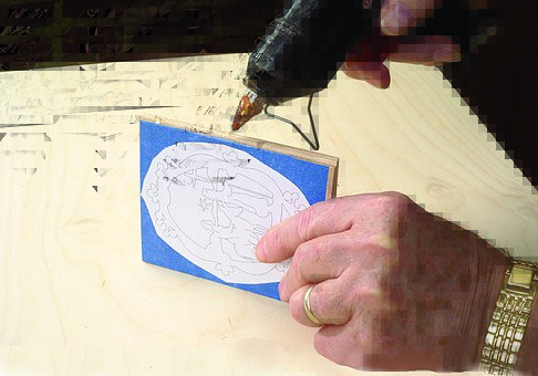

Stack Cutting
Stack cutting lets you cut several pieces of a project—or even several projects—at one time. Essentially, you attach several blanks together and cut them as one unit.
One way to attach blanks is with tape. Align all of the layers and wrap a layer of tape around the outside edge. You can also wrap the whole stack in tape for extra stability. Use masking tape, painter’s tape, or clear packaging tape.
Hot-melt glue is another option. Glue the blanks together with a dot of hot-melt glue on each side.

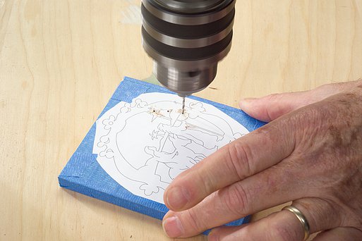

Some patterns have blade-entry holes marked. If the pattern doesn’t, place the holes near a line to be cut to prolong the blade life, but don’t place the hole on a curving line or inside corner (if possible).  Drill the hole perpendicular to the blank. Use a drill press if you have one; otherwise, use a hand drill and make the holes as vertical as possible. Drill through the blank into scrap wood to prevent tear out on the back side of the blank. If you have the space, use a larger bit—it will make it easier to thread the blades through. For thin veining cuts, use the smallest bit the blade will fit through.
