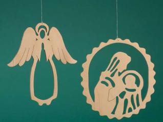

issues-ssw33-Ornaments-silo1New pattern attachment method and web-exclusive ornaments
