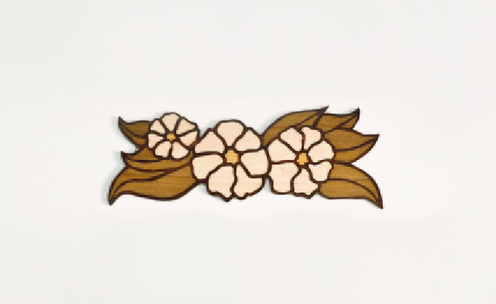

Inlay techniques produce impressive projects, but the process is as simple as stack cutting fretwork. These small designs can be completed in one day and make beautiful magnets or pins. Once you master the techniques, you’ll have the confidence to tackle more complex projects, such as box lids and plaques.

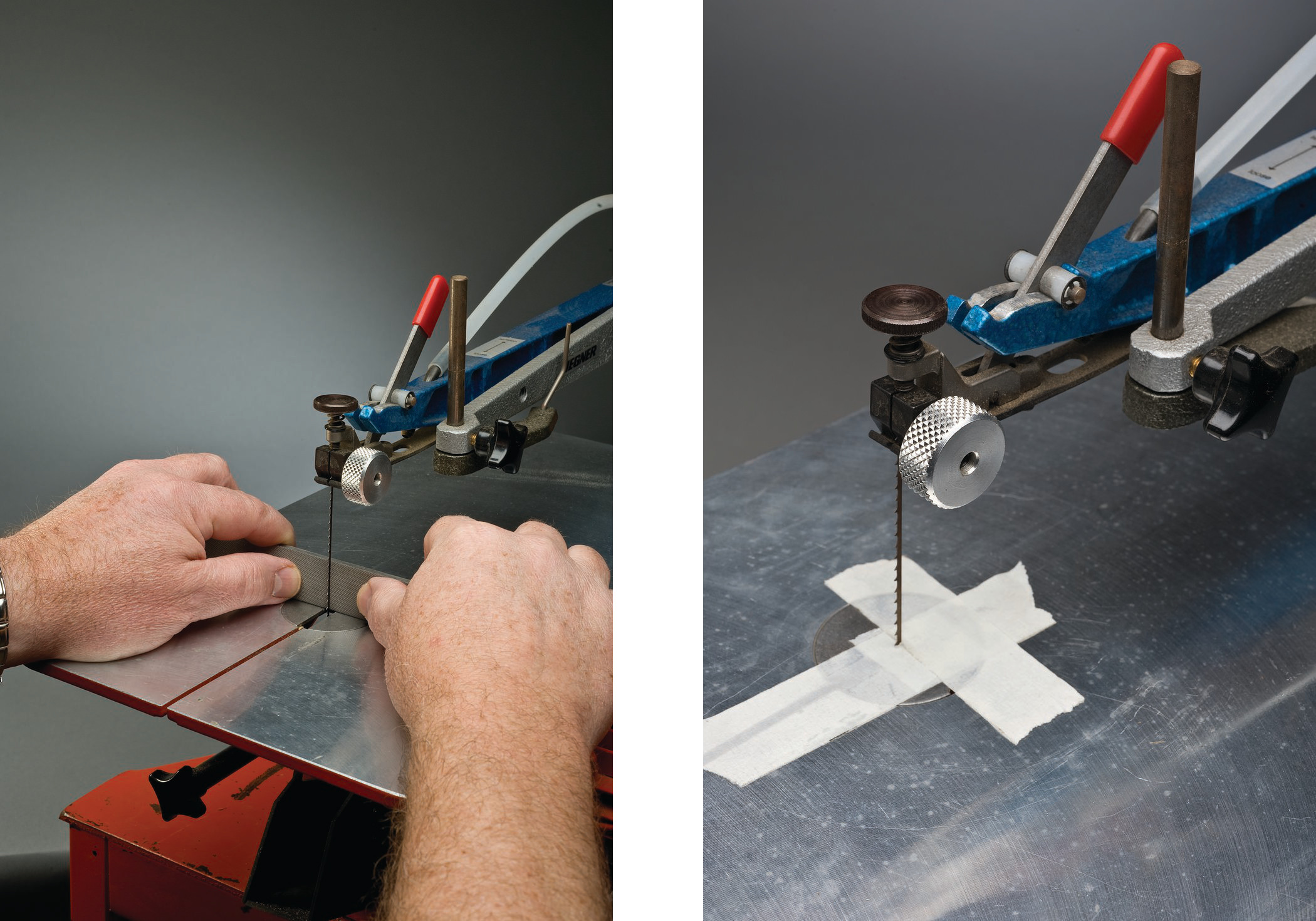

1. Prepare the blade and saw table. File the back of the blade with a metal file to make tight turns easier. Add a zero-clearance table insert to your saw table. This can be as simple as masking tape or a business card taped to the table.

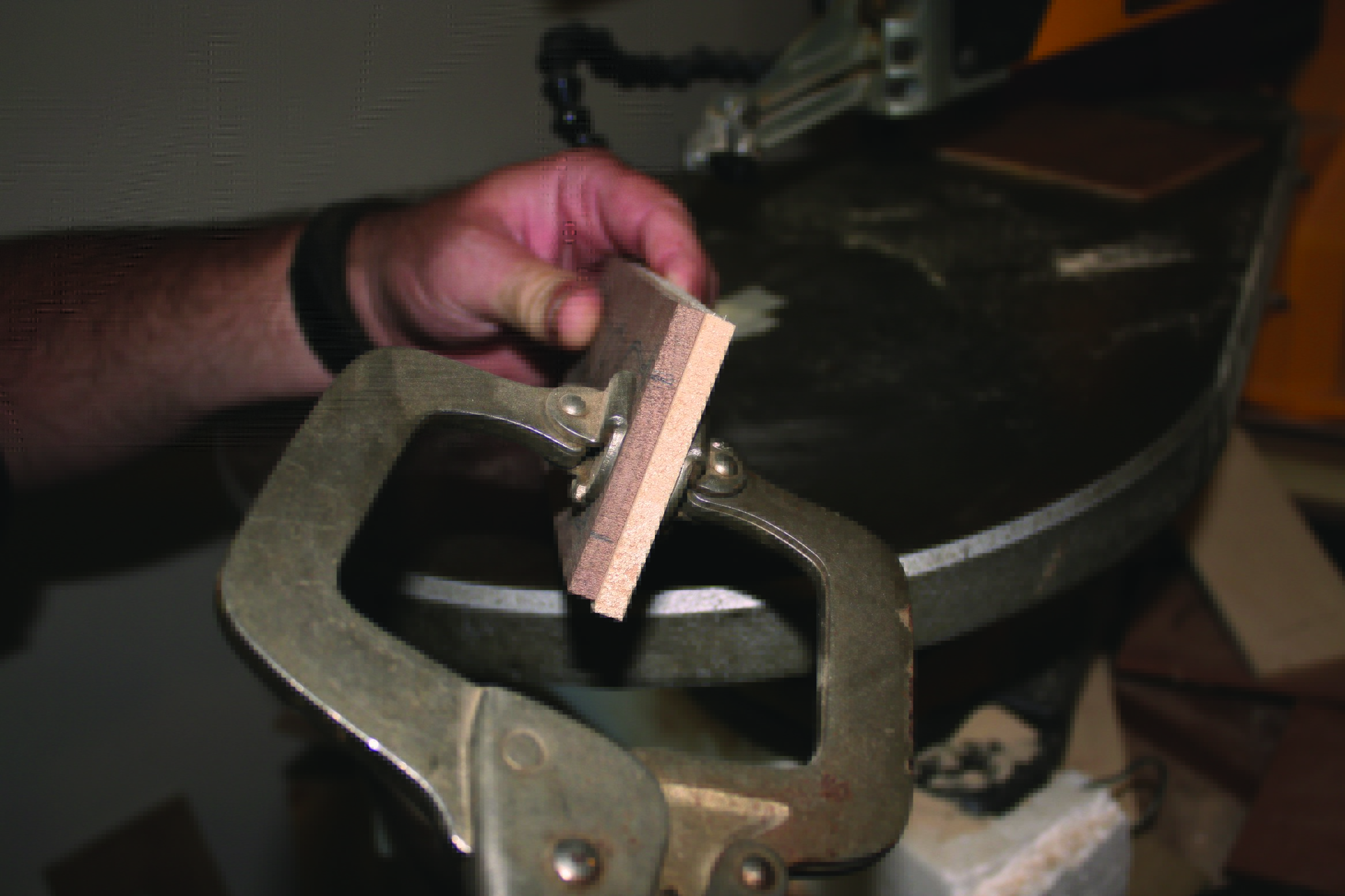

2. Create the stack. Trace the pattern onto the walnut. Attach the aspen to the bottom of the walnut using double-sided tape. Mark the location of the tape to make it easier to separate the stack later. Use a locking C-clamp to ensure a good tape bond.

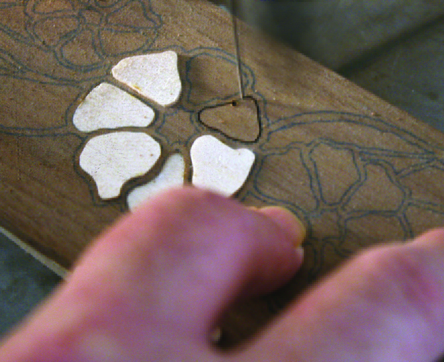

3. Set the table angle. Tilt the left side of your saw table down 21/2° to 3°. Cut counterclockwise and make an oval test cut in the scrap wood outside the pattern lines. Test the fit of the aspen into the walnut. You want the aspen to stick up above the walnut about 1/32″. Adjust the table angle as needed.

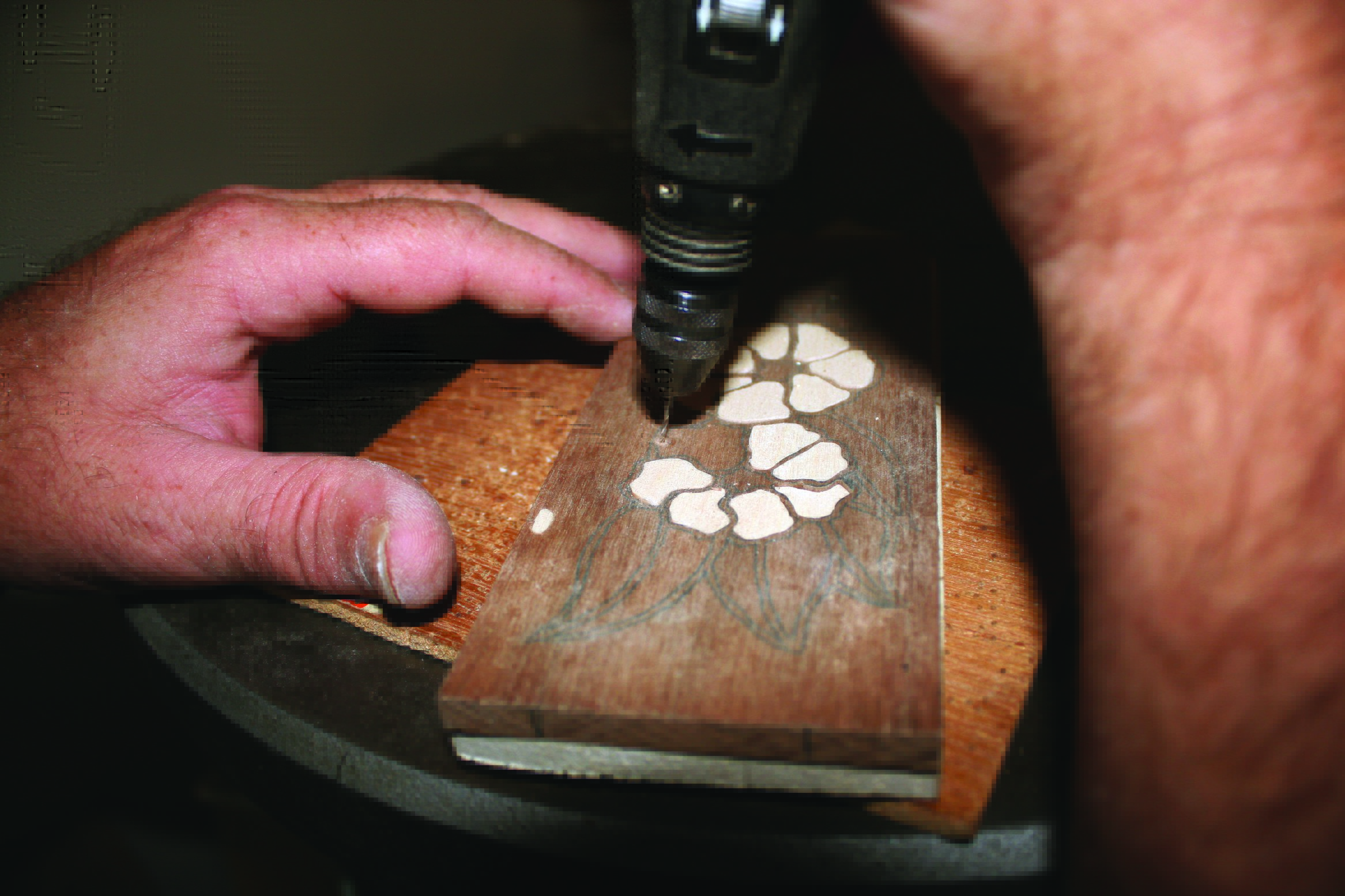

4. Drill blade-entry holes. Hide the blade-entry holes by drilling at an angle along straight sections of the lines. The bit enters on the inlay side of the pattern line on the top piece of wood and exits on the waste side of the inlay section on the bottom stock. A slightly steeper angle is better than not enough.

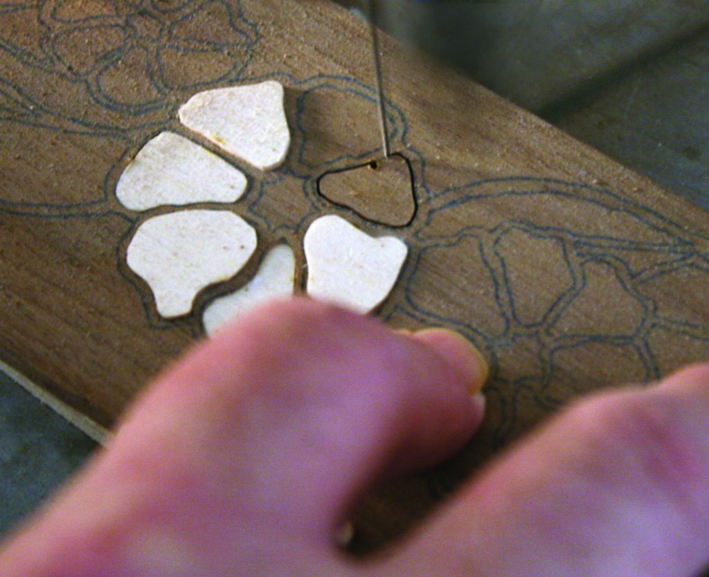

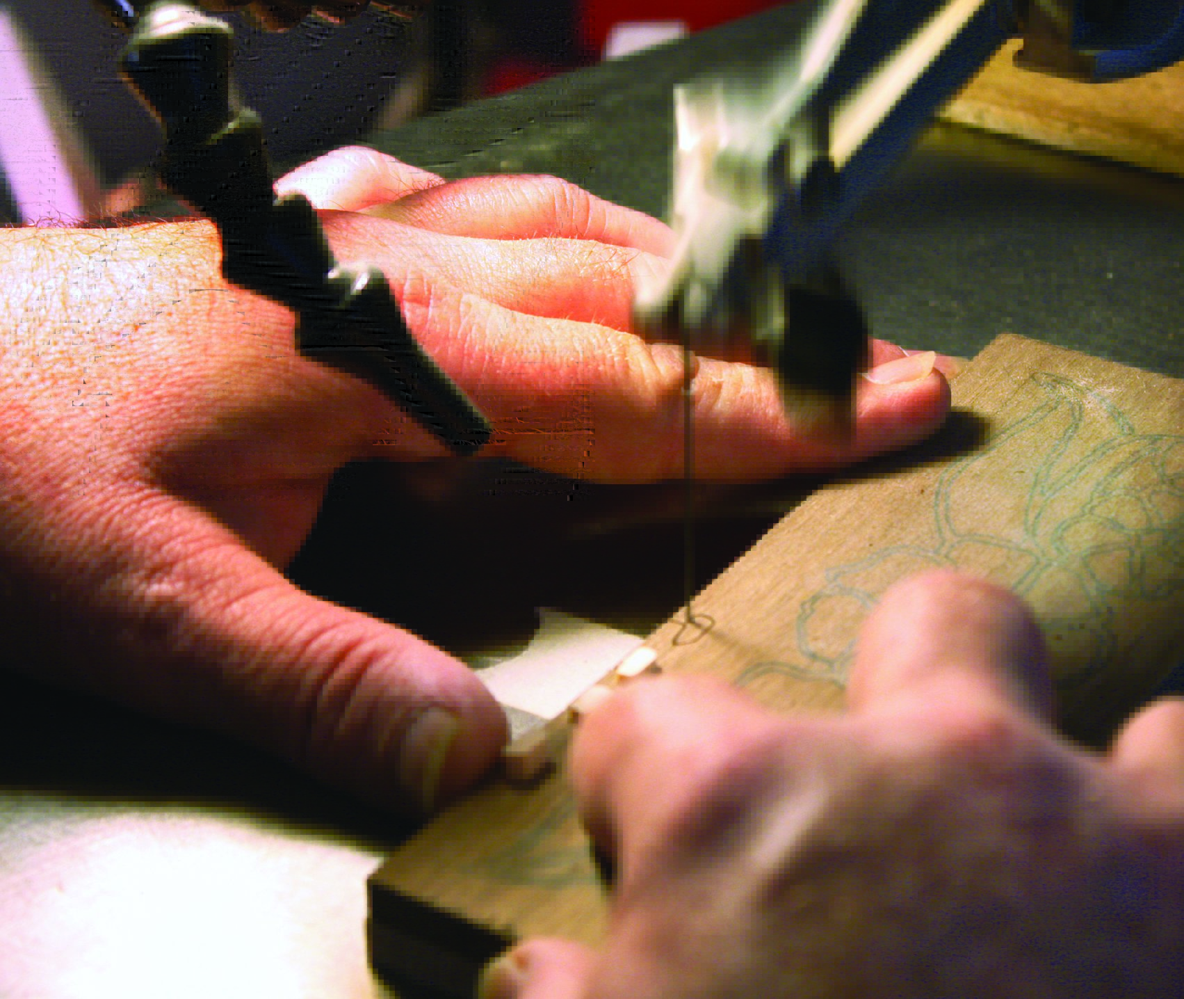

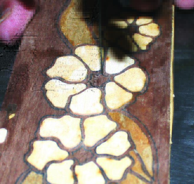

5. Cut the first inlays. Turn the wood clockwise so the saw blade cuts counterclockwise. As you approach the blade-entry hole to finish the cut, concentrate more on meeting the previous cut than following the line.

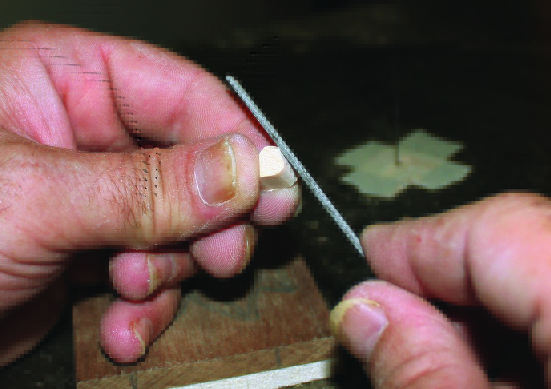

6. Remove the burr from the inlay piece. Remove the pieces through the bottom. Use a flat needle file to remove the burr created when you drilled the blade-entry holes. Use the scrap walnut to push the aspen inlay up from the bottom.

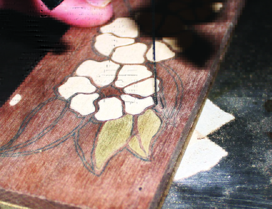

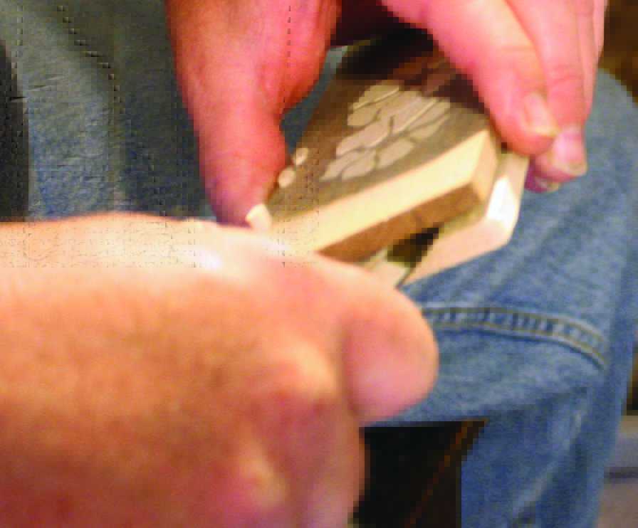

7. Prepare for the second inlay color. Separate the stack using a bench knife. Sand the back of the walnut so you have a flat surface to attach the stock for the next inlay color. Attach the poplar to the bottom of the walnut using double-sided tape.
8. Cut the leaf inlays. Use the techniques explained above to drill blade-entry holes and cut the inlays for the leaves. Be careful when cutting the fine detail lines inside the leaves. Push the poplar inlays into the walnut stock.

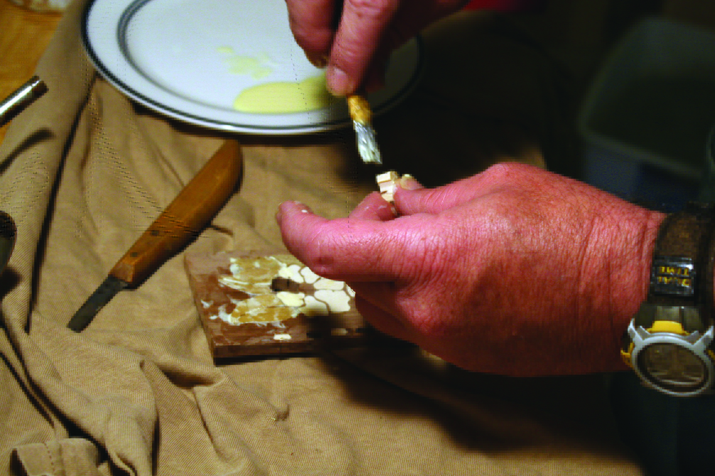

9. Glue the inlay sections in place. Remove the pieces one-by-one and apply glue to the edges with an artist’s brush. Work from one side to the other. Allow the glue to dry for three hours. This provides support to the thin sections of the walnut.

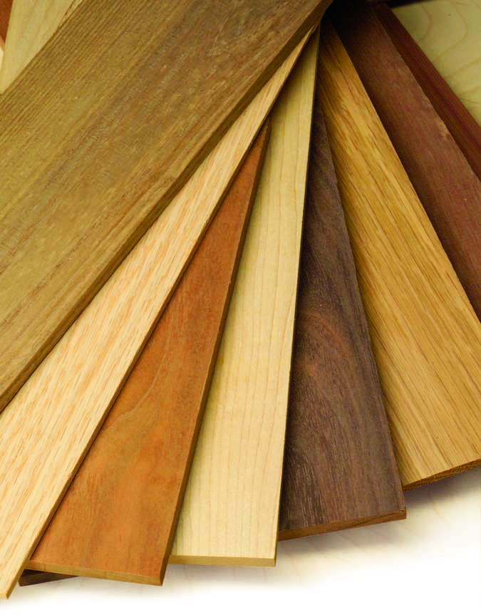

  • 1/4″ x 2 5/8″ x 6 5/8″ walnut or dark wood of choice
  • 1/4″ x 2 5/8″ x 6 5/8″ aspen or white wood of choice
  • 1/4″ x 2 5/8″ x 6 5/8″ poplar or medium-dark wood of choice
  • 1/4″ x 2 5/8″ x 6 5/8″ satinwood, yellowheart, or yellow wood of choice
Earth:
  • 1/4″ x 3 1/8″ x 3 1/8″ butternut or medium-tone wood of choice
  • 1/4″ x 3 1/8″ x 3 1/8″ basswood, aspen, or white wood of choice
Acanthus Leaves:
  • 1/4″ x 3 1/2″ x 5″ walnut or dark wood of choice
  • 1/4″ x 3 1/2″ x 5″ poplar or medium-dark wood of choice
