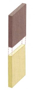

Panel joint

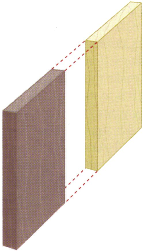

End Grain Joints
Joints made by gluing end grain are weak and often break apart if you rely only on the glue, which absorbs into the wood. If you must glue end grain, reinforce the resulting butt joint with brads, dowels, a corner block, or metal corner braces.

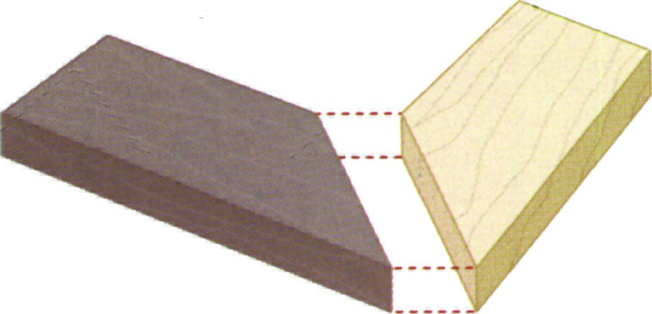

Miter Joints
A miter joint consists of two ends cut at angles and glued together. While they look nice from the outside, miter joints are extremely weak glue joints because they essentially create a double end-grain joint. If you really want to use a miter joint, reinforce it with small brads, a corner block, or a metal corner brace.

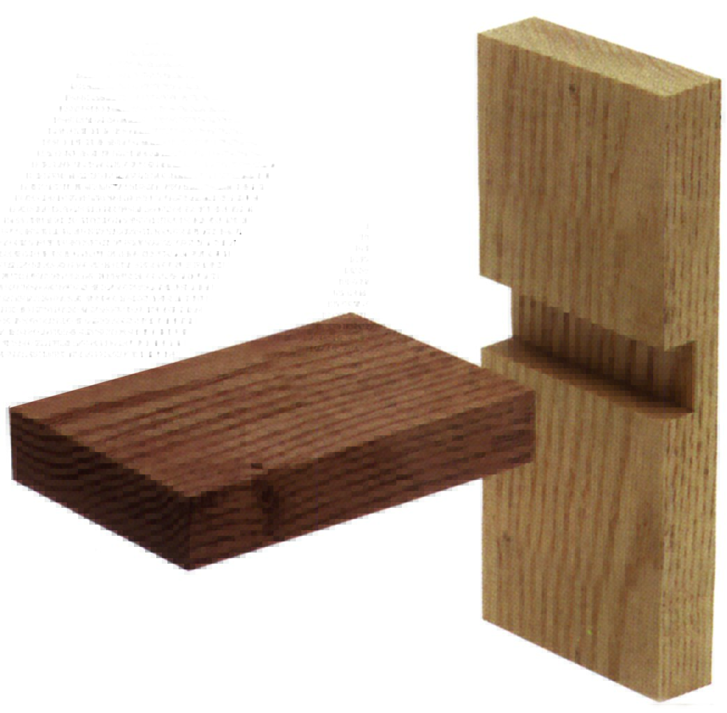

Dade joint
Use

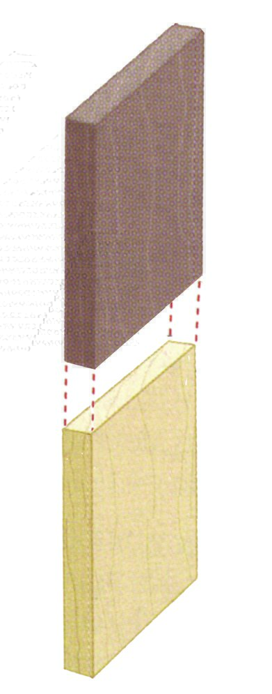

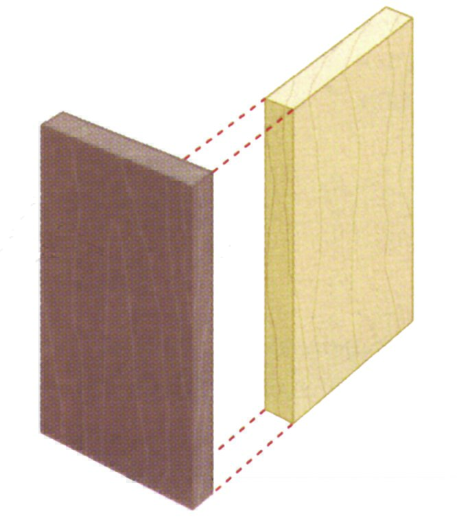

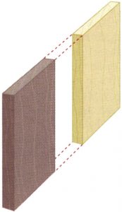

Panel Joints and Edge Joints
When you glue the edges of two pieces of wood together with the grain running the same direction, it’s called a panel joint. These joints are extremely strong as long as the edges are flat, square, and smooth. An edge joint is similar, but instead of joining the two edges, you join the edge with the flat side of another board. This is also a strong joint.

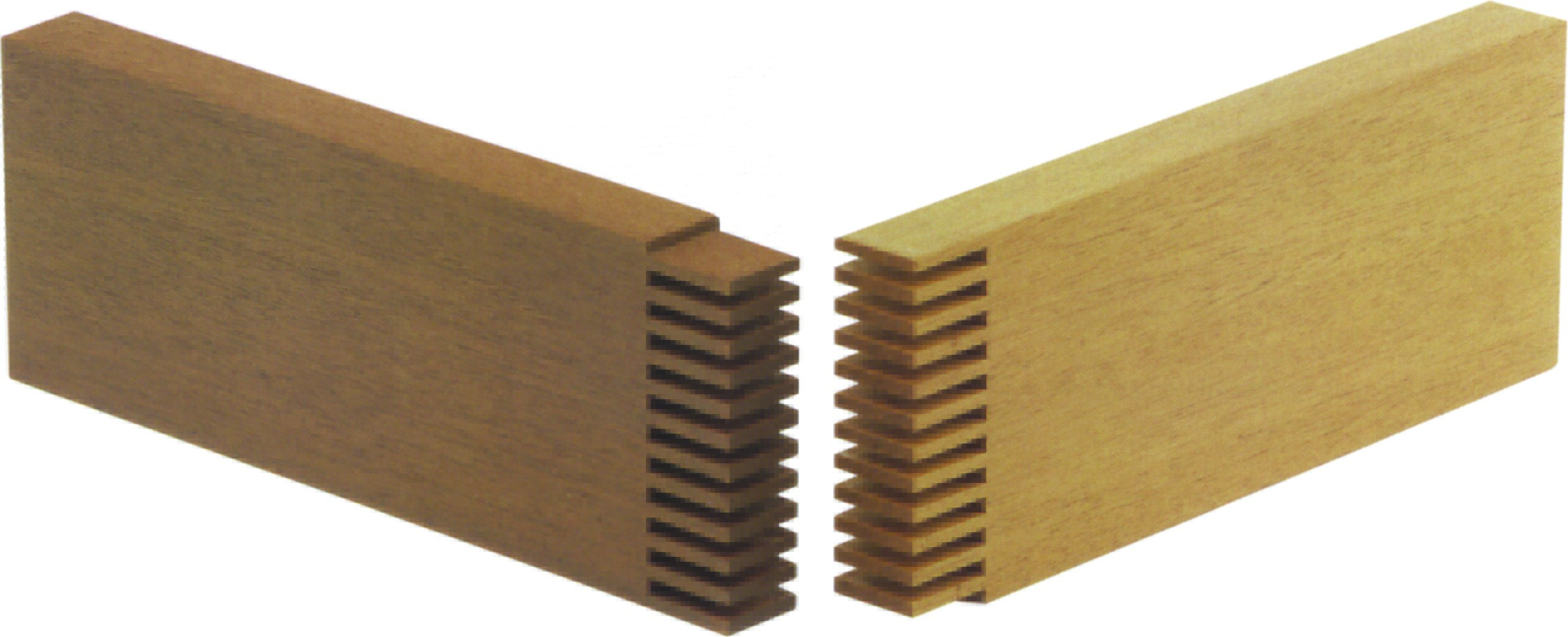

Finger joint
Grooves, Dados, and Rabbets
Grooves, dados, and rabbets are all types of notches in the wood, and they are often used to add a bottom to a box. If a box bottom is made with solid wood and glued in place, it will expand and break the box apart. To avoid the problem, cut grooves in the box walls that are slightly wider and deeper than the box bottom is thick and long. Assemble the box walls and “float” the bottom in the grooves without gluing it, thus giving the bottom panel space to expand as needed.

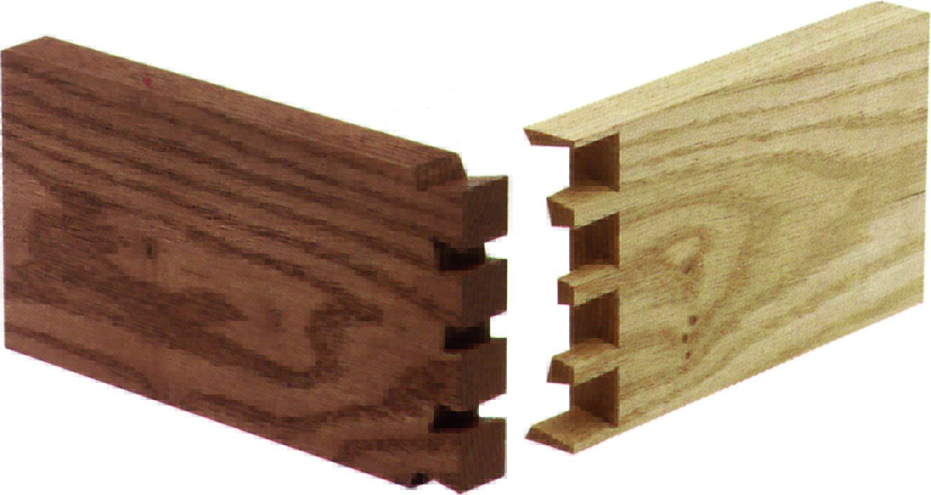

Dovetail joint
Box joint

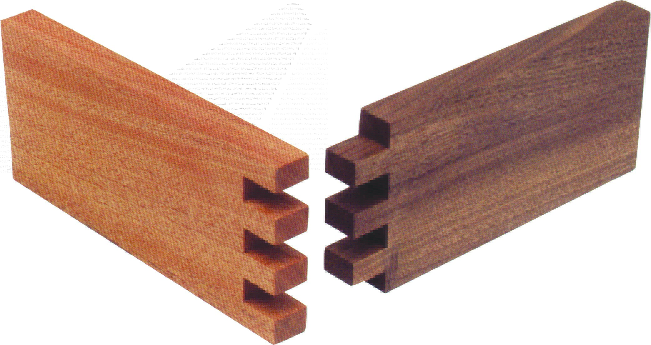

Dovetails, Finger Joints, Box Joints
These joints all use interlocking pins to assemble pieces both by fitting together and by offering a much greater glue surface than that of a flat piece. You will often see these strong joints used for boxes and drawers; dovetails, especially, will hold together even without glue. While it is simple to use routers and templates to cut these joints, the templates limit the size and shapes of the pins. Many woodworkers use handsaws and chisels to create custom pin sizes.
