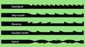

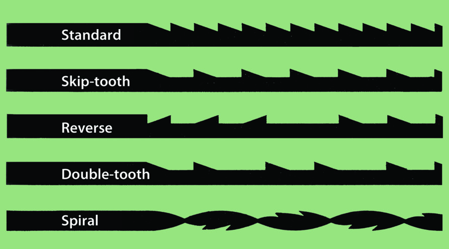

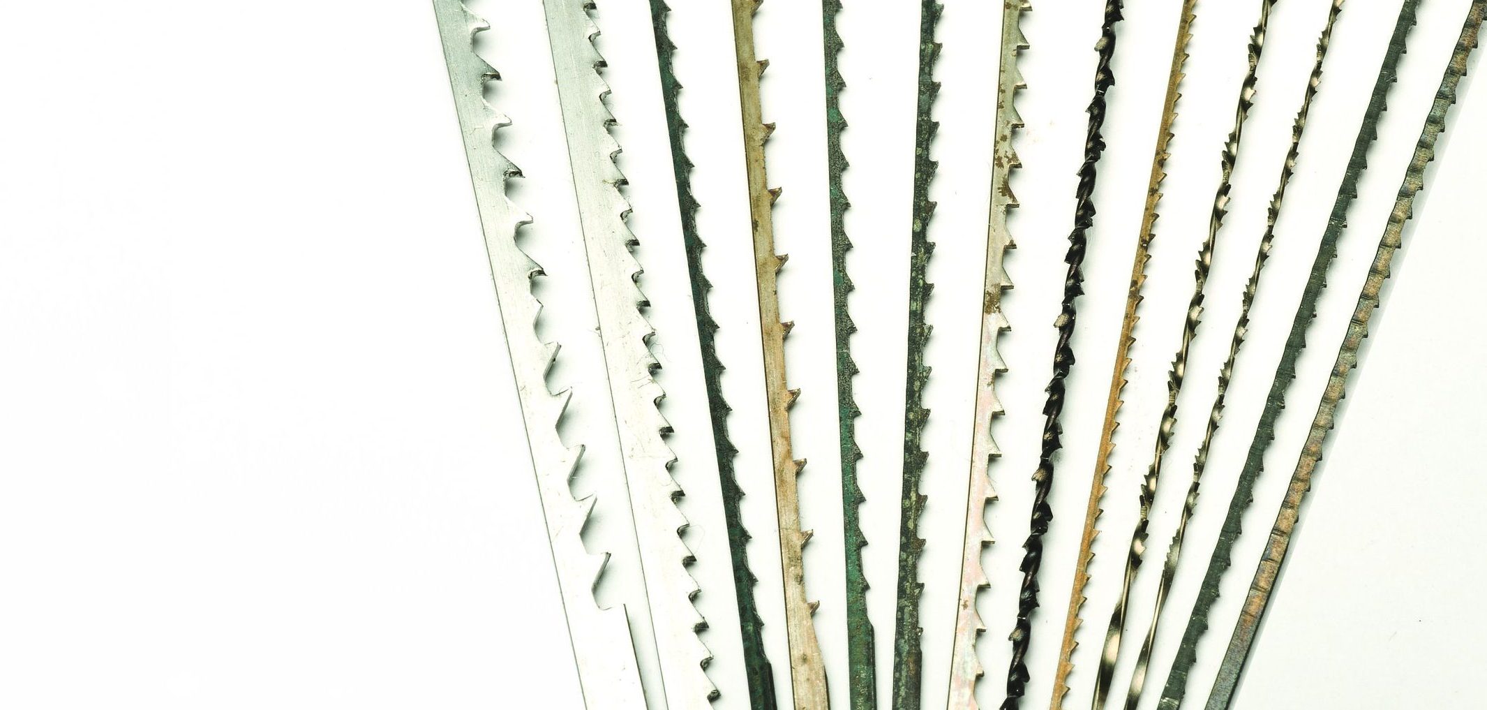

Choosing the Right Teeth
Use skip tooth blades when you need a fast cut and are not concerned about splintering on the bottom. Use reverse-tooth blades when you need a relatively fast cut that leaves a smoother surface on the bottom. Use double-tooth blades when you need a smooth cut and aren’t concerned about speed. Use spiral blades when you need to cut in various directions without turning the wood.

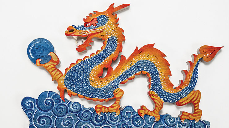

According to Chuck Olson of the Olson Saw Company, the reverse-tooth scroll saw blade was first developed by Olson in the late 1950s for Playskool. Playskool was stack cutting 10 puzzles from 1/8″-thick wood, and had to throw away the bottom puzzle because of tear out. Reverse-tooth blades prevented this and increased productivity. Olson introduced the reverse-tooth scroll saw blade to the general public in the early 1980s.
