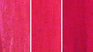

Acrylic paint thinned with water. From the left:
One coat of wash, two coats of wash, undiluted paint.
Diluting with water
Start with a mixture of 1/2 teaspoon of acrylic paint with 11/2 teaspoons of water (1:3 ratio). The wash goes on clean and is absorbed evenly. Once dry, the wood surface is smooth. There is no odor which is another benefit.

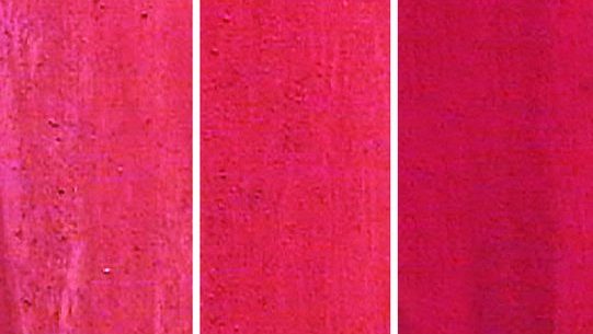

Diluting with rubbing alcohol
To accurately compare the two diluting agents, use the same mixture ratio: 1/2 teaspoon of acrylic paint with 11/2 teaspoons of rubbing alcohol. The wash becomes very gritty and leaves crumb-like particles on the wood. The color doesn’t absorb well and the pigment in the paint is compromised, leaving an undesirable color behind. I also don’t care for the odor of this wash.
Acrylic paint thinned with rubbing alcohol. From the left: One coat of wash, two coats of wash, undiluted paint.

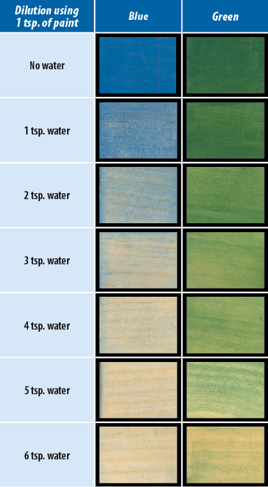

If you feel the wash is too light, apply subsequent coats or try a stronger wash. The following chart illustrates the variety you can achieve using different ratios of water with the same portion of paint.

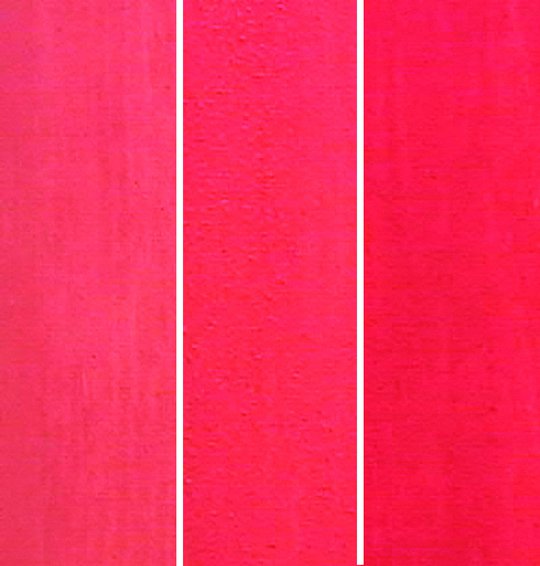

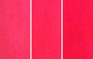

There are several brands of acrylic paints and price is not always an indicator of quality. Colors with similar names across brands can produce dramatically different results. Experiment with different brands to find the one you like best.

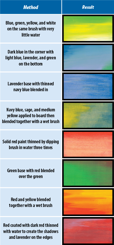

Acrylic paints and washes are easy to layer and blend. If you want to create a custom color, mix the paint prior to creating a wash, or use one of the methods below to create a specific result. Be sure to test the paint or technique on the same wood you plan to use in your project. Experiment with the mixtures and techniques. When you have one that works well for you, make sure to document the ingredients and their measurements so you will be able to duplicate it again in the future.
