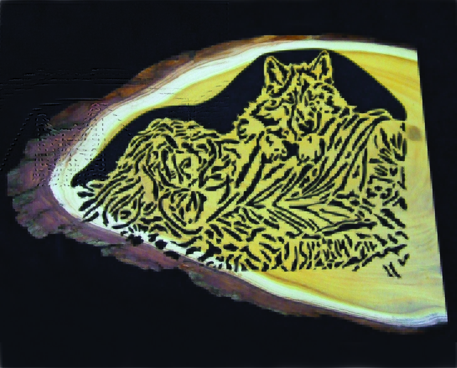

If you look closely at Spanish cedar, you can see that it has a pronounced grain. While the grain isn’t nearly as open as oak, it is more open than poplar or walnut. This open grain does make it more prone to breaking with the grain, but I’ve been successful cutting pieces less than 1/4″-thick; it just requires a bit of forethought when you place the patterns.
