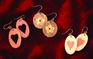

These inlay earrings are an ideal way to use up the scraps of hardwood left after cutting your Christmas ornaments. You can cut several in a day as gifts for family, friends, or yourself!
Start by stacking two contrasting colors of hardwood together by running a bead of hot glue around the outside edges. Do not use double-sided tape; the pieces need to fit tightly together for the inlay to work properly.
Attach the pattern to the work piece and drill blade-entry holes for the inlay section with a #63 drill bit. Drill the holes for the earring hooks with a 116“-diameter bit.
