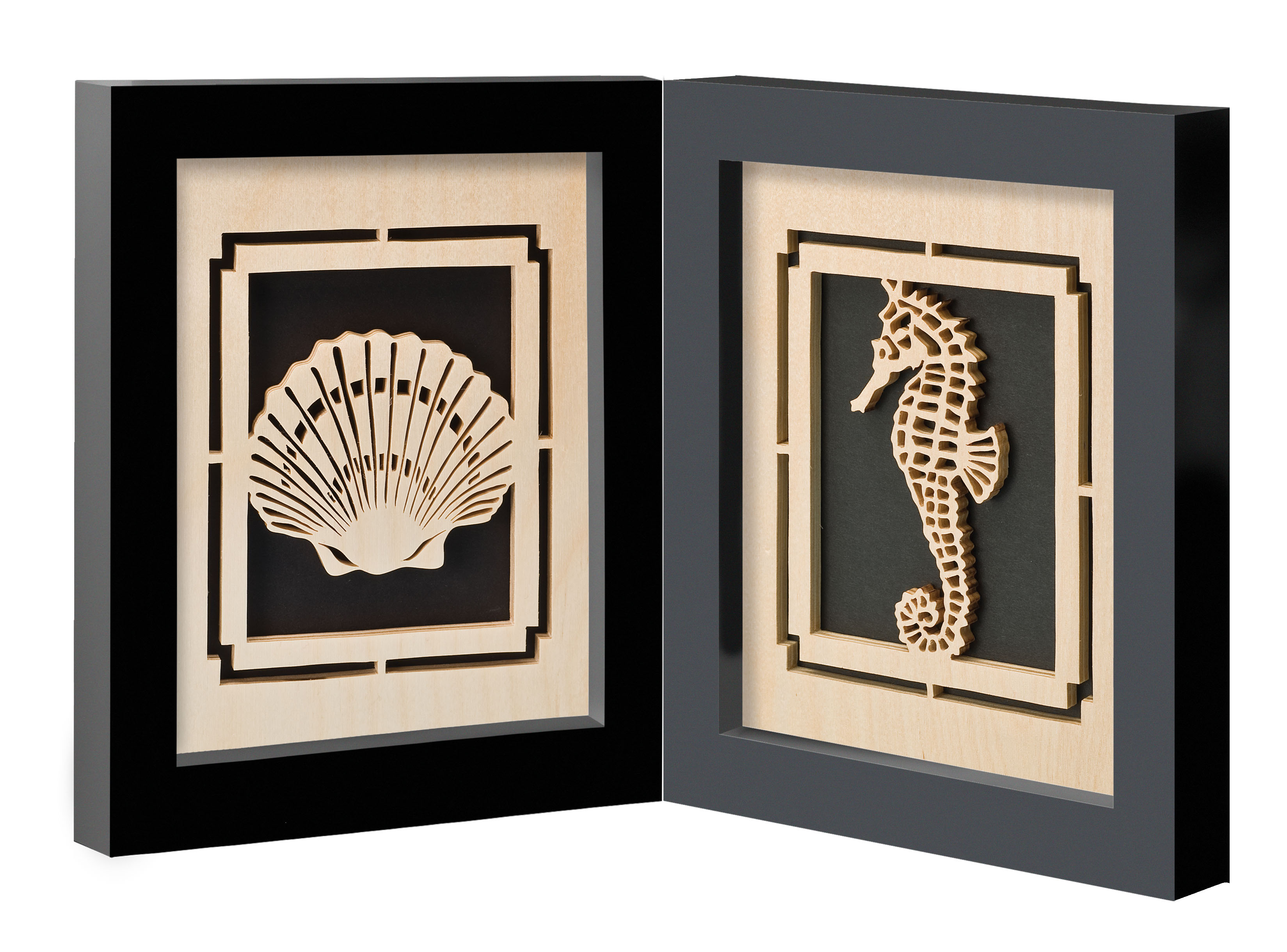

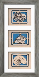

I have always been fascinated with the flowing shapes of creatures that live underwater. These simple yet elegant images were originally designed as paper cuttings. Many paper cutting patterns are easily cut on the scroll saw, with little to no adjustments needed. Each of these six designs have their own integrated matte, so you can display them any number of ways, adding the perfect touch of the seashore to your home décor. Frame each panel individually, mount several in the same frame for a polished look, use individual patterns to decorate a box lid, or cut the patterns from paper to make an overlay for custom note cards.
Cutting and Finishing
Cut the blanks to size with a table saw or circular saw to ensure straight edges. You can also stack cut these patterns, if desired. Attach the patterns to the blanks with spray adhesive. Drill the required blade-entry holes.
Cut the frets with a #3 reverse-tooth blade. Remove the patterns, and then sand away any fuzzies. Apply your finish of choice.
