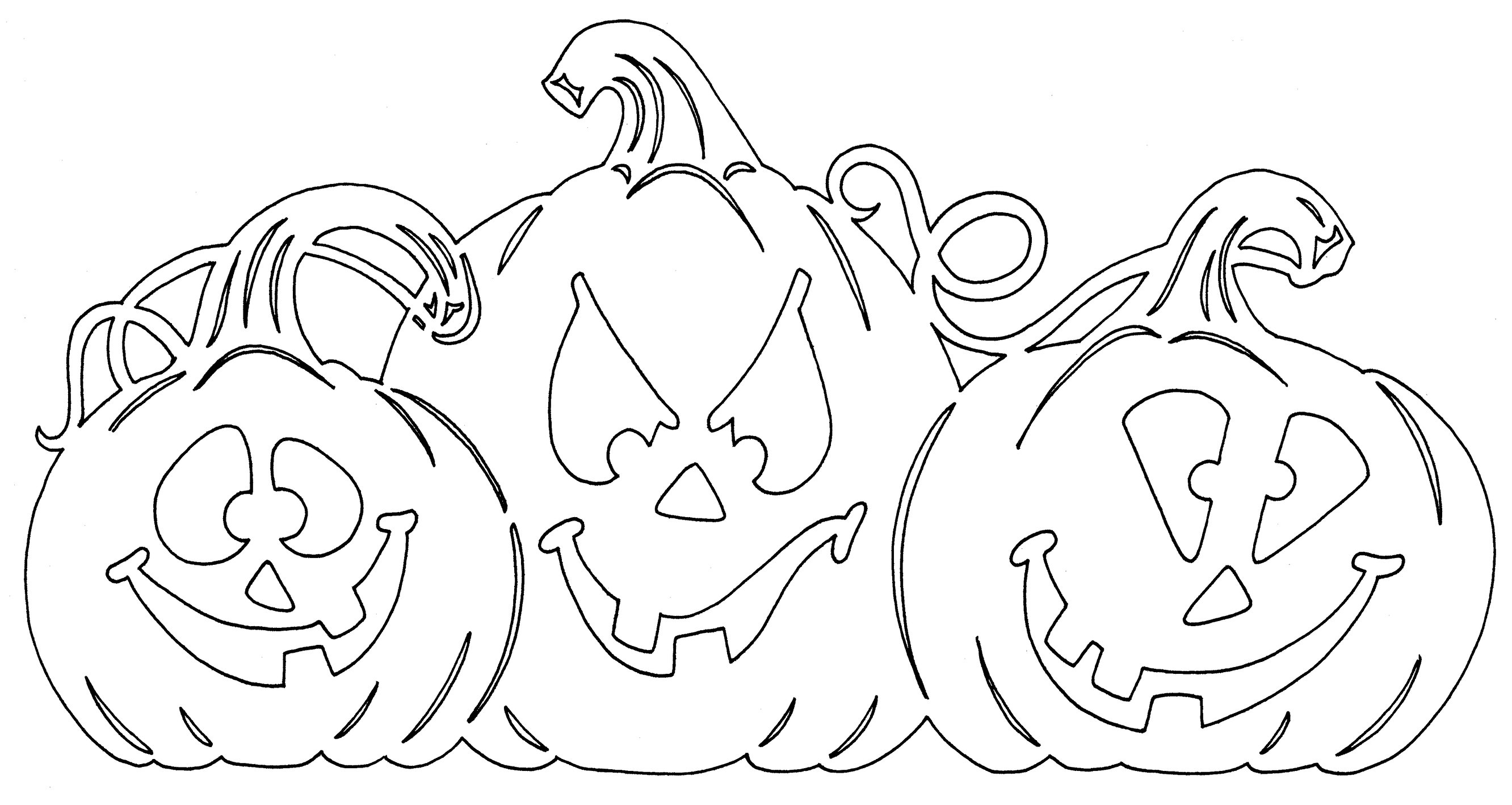

This whimsical pumpkin trio can be used in a number of ways. You can add a base and a tea light for an instant shadow-caster, cut them out of paper for a custom greeting card, scroll them from Baltic birch and add some fall colors for a unique decoration or cut individual pumpkins and add hardware for a unique pin. Start by sizing your patterns to meet your needs. The pattern provided is sized for use as a candle holder.
Assembling the Tea Light
Step 1: Cut out the base. Drill a 1 3/4″-diameter hole 1/4″ deep into the base to hold the tea light.
Step 2: Glue the base to the pumpkins. Use good-quality wood glue. Clamp the pieces overnight.
Step 3: Apply your finish of choice.
