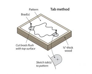

I like using the tab, or ear, method of stack cutting. With this method, you drive nails into areas close to the pattern and only cut them off after finishing the rest of the cuts. You only have to hold the stack for a couple of short cuts, and you can use tape to secure it if you like.
You can use the method on any pattern; just draw a few tabs onto the pattern fairly far apart, add the nails, and start cutting. Learn how the tab method works below, and then try it out on the free stack-cutting pattern. You can also try the tab method on one of our holiday projects

Make the stack. If the tabs are not already on the pattern, draw them in positions as far from each other along the cutting line as possible. Align all of the blanks under the top blank, drill pilot holes through the tabs, and drive nails through the whole stack. Cut the nails flush with the stack if necessary.

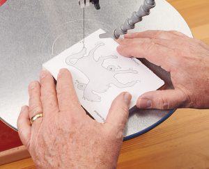

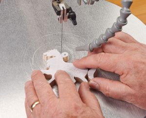

Cut the pattern. Follow the lines and cut in from the edge of the blanks. Make one smooth, continuous cut around the pattern. DO NOT CUT THE TABS OFF YET. When you’ve finished cutting around the horse, hold the stack together tightly (or add a few pieces of tape) and cut off the tabs.
