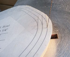

Cut the pieces. To reduce the amount of sanding, you will want to set the table angle as exactly as possible; for a 3/4″ (1.9cm)-thick piece, set the angle to 19°. If you prefer the pilot hole method to the ring-cutting method (click here), drill a pilot hole on each ring line using a drill or rotary tool and a #56 wire size bit. Then cut the rings and base on a scroll saw.

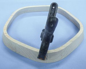

Glue the rings back together. Note: This only applies if you chose the ring-cutting method. My glue of choice is RapidFuse wood adhesive. It is a clear modified cyanoacrylate (CA) glue formulated specifically for wood. It is water-resistant and easy to sand, and will not affect most stains or finishes. Secure with spring clamps while drying. Flatten the top and bottom of each ring ring with a 180-grit shop-made sanding tile. Dry-assemble the bowl to check for any gaps between rings, and sand away any remaining gaps.

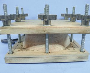

Assemble the bowl. Start with the top ring, face down, and add a bead of wood glue, spreading it thinly along the gluing edge. Add the second ring and press down the assembly with a heavy book, or in a bowl press. When dry, add the third ring and follow the same method; adding the rings one by one decreases the likelihood that they will slide and become misaligned. Do not add the bottom yet.
Step 4

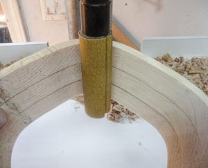

Sand the interior. I used a sleeveless drum sander and regular sandpaper sheets rather than sleeves. Sand to 220-grit. Wipe off dust with a tack cloth, and then glue on the bottom of the bowl. Weight it down and check for squeeze-out. Let dry.

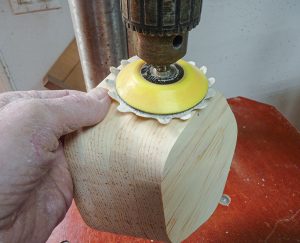

Sand the exterior. I used 220-grit disc in a flexible pad sander to ensure clean, smooth lines from top to base, but you could use a belt sander, if desired. Depending on your desired finish, more sanding may be necessary later. Round over the edges of the bowl rim and base.
