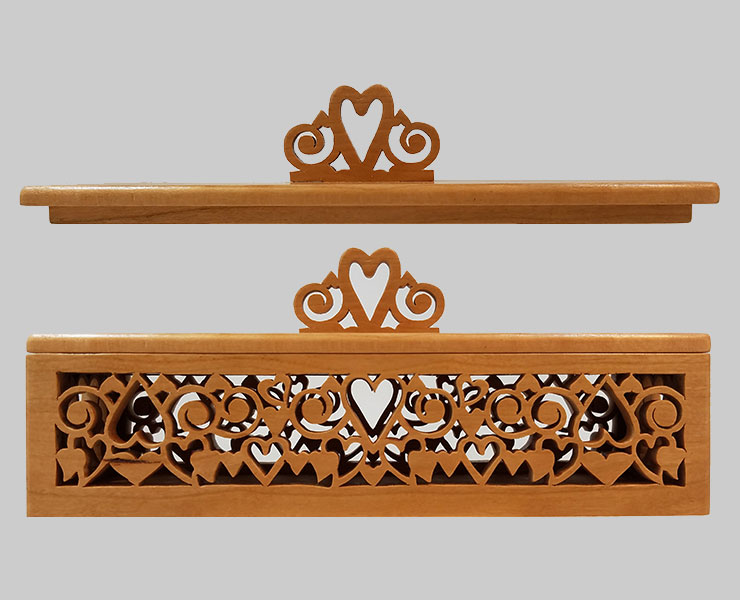

Fretwork Heart Box
This challenging design will showcase your cutting skills
By Sue Mey
Cut by Rolf Beuttenmuller
For a gift they’ll love both now and later, cut this keepsake box and fill it with your Valentine’s favorite treats. The box is sized for storing trinkets, but you could also upsize the pattern to make a larger box for big gifts.
Making the Box
Cut the design, and then cut the perimeter of each piece. Carefully sand the pieces. Glue and clamp all four sides to the base. Center the lid liner on the lid and glue it in place. Glue the handle to the top. Apply a clear spray finish.
Materials
• Wood, such as cherry, 1/4″ (6mm) thick: 5″ x 25″ (12.7cm x 63.5cm)
• Sandpaper
• Wood glue
• Finish: clear spray
• Scroll saw with blades: #1 reverse-tooth
• Clamps
