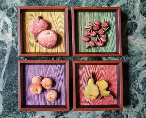

Celebrate the earth’s bounty by shaping and dyeing a four-panel composition that looks good enough to slice up for breakfast. This project is a great way to practice texturing and tinting, even if you’re new to the scroll saw. Jump in and experiment with the hues you love best.

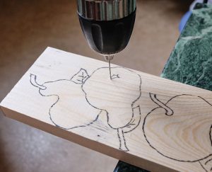

Getting StartedFor this project, choose wood with a pronounced texture and grain; I used pine. Measure and mark the dimensions of the backers on a 3/4″ (1.9cm)-thick plank. Then apply the patterns for the fruit on a 3/8″ (1cm)-thick plank. I used graphite transfer paper and a pencil, but you can save time by attaching the design directly. Cover the wood with blue painter’s tape and stick the pattern to the tape with spray adhesive. Drill the blade-entry hole in the bottom of the pear. |

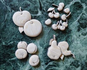

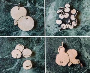

Step 1Cut the fruit. Use a #3 reverse-tooth blade or one of your choice. (I used a Pyrosegmentator—a cutting tool of my own design—but you can use a scroll saw.) Leave the inner vein details on the leaves uncut, as you will woodburn them later. The stems should all exist as individual pieces. |

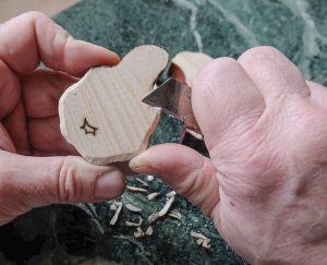

Step 2Rough shape the fruits. I used a utility carving knife and sandpaper, but you can use a round inflatable sander to contour the edges, if desired. Note: Always wear a carving glove and thumb guard. The photos were taken without them to clearly show hand and knife positions. Round the edges, adding ripples on the surface to enhance the fruit-like shape. For fruits that are touching, such as the two pears, bring down the edges of the piece that is farther away so that the fruit in front sits higher and appears closer. A 5/16″ (8mm) #8 gouge, or one of your choice, can be helpful here. |

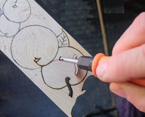

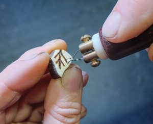

Step 3Add the leaf details. I burned in the veins with a writing nib in a variable-temperature woodburner. |

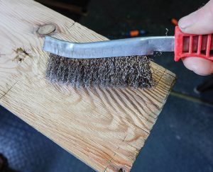

Step 4Texture the fruit backers. I create dramatic texture with a technique called wood brushing. Use a metal scratch brush with medium bristles to rub the surface of the wood aggressively, working with the grain. Then cut the plank into squares with a table saw, compound miter saw, or the scroll saw with a #7 blade. |

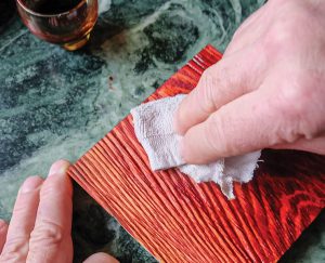

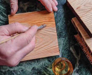

Step 5Add color to the fruit backers. To do this, first wet the surface of each panel with a little water. Then apply the stain of your choice to the wet surface. As soon as you’ve applied it, rub the surface vigorously with a clean rag. |

Step 7Assemble the panels. Glue the fruit pieces on their respective backers, one by one. Apply a clear varnish once dry. At this point, add store-bought frames, if desired. |
Step 8If desired, add a backer. You could display the pieces individually, but I prefer to unite them with one tempered hardboard backer. Orient the panels on the backing material as desired, trace around them, and cut the backer accordingly. Cut the scrap wood spacers and stain as desired. Glue and clamp the panels to the backer and let dry. Add a hanger to the back and display. |
