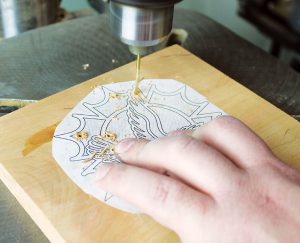

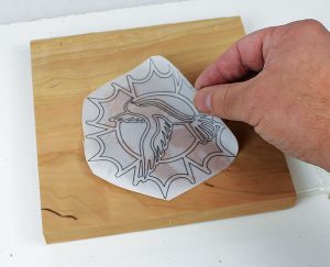

Getting StartedCoat the back of the pattern with spray adhesive, and then apply the pattern to the surface of the wood plank. I used cherry. Be generous with the amount of spray adhesive used. If there is not enough, the pattern will start to peel off as you cut. Once the spray adhesive dries, use a drill press to drill pilot holes 1/8″ (3mm) in diameter. |

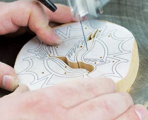

Step 1Cut all the inside cuts. Using a #5 standard blade in your scroll saw, start cutting out the inside shaded areas of the project. There is no right place to start, but I like to start close to the center and work my way out from there. |

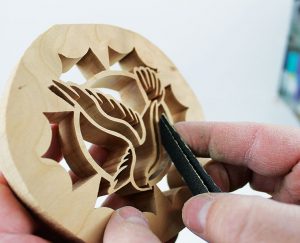

Step 2Sand the edges. Use 120-grit sandpaper to knock any loose wood burrs or dust off the freshly cut edges. |

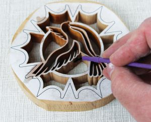

Step 3Seal the edges. Use a small paintbrush and polyurethane to seal the sides of the cutout areas of the inside cuts. This will prevent the resin from soaking through the grain, which will cause color bleed. |

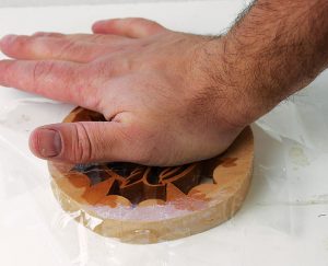

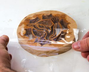

Step 4Create a mold. Use clear packaging tape to close off the bottom of all the inside cuts. Use several layers and press it firmly onto the wood. This will create a tray for your resin pour. |

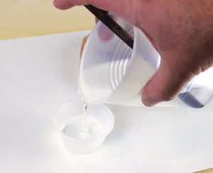

Step 5Mix the resin. Mix approximately 6oz. (177.4ml) of tabletop epoxy resin. Once mixed, separate it into several smaller cups. These will turn into the individual colors that will get poured. |

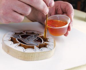

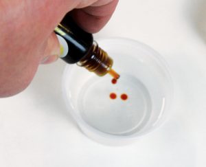

Step 6Mix in color and pour the resin. Put a few drops of color of your choice into the smaller cups and mix them thoroughly. Pour the colored resin into whichever sections that you want, using a small stick to direct the pour. Hold the stick against the edge of the cup and tilt the cup until the resin begins creeping down the stick. This will give a very narrow stream that is easy to direct. |

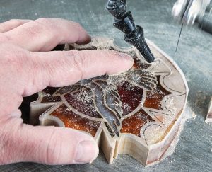

Step 7Allow the epoxy to harden, then cut. Place the filled project off to the side where it won’t collect dust and let it set to harden for at least 24 to 48 hours (check manufacturer’s instructions). Once it’s hardened, take it back to the scroll saw and cut out the final shape of |

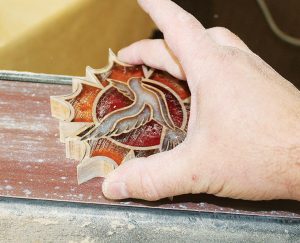

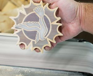

Step 8Sand off the pattern and tape. Use a belt sander to sand flat the top and bottom of the workpiece. Sand low enough that the pattern and tape are sanded off and any low spots where the resin shrank are now flat. |

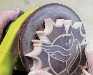

Step 9Sand the workpiece smooth. Hand-sand both sides and all edges starting with 120-grit and then 220-grit. Use 320-grit to achieve a super smooth finish. You can do this by hand or with an orbital sander. |
