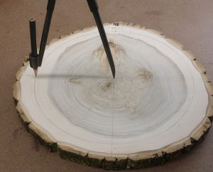

Draw the first cutting line. Choose the more attractive side for the inside of the bowl. Measure the diameter across the wood; do not include the inner bark. Since the round is unlikely to be truly circular, take several measurements to determine the largest diameter that will fit inside the bark area. Use this diameter to draw a circle on a sheet of paper. Cut the circle precisely and fold it sharply into quarters to create a template. Unfold the template. Position it on the round so that the wood surrounding the template is as evenly distributed as possible, and then secure it with small pieces of masking tape. Mark the center point with an awl and the endpoints of the fold lines with a pencil. Remove the template and connect the endpoints through the awl mark to create intersecting registration lines. Continue the lines to the outer edge of the bark. Place a compass at the center point and draw a circle with a diameter 1″ (2.5cm) smaller than the diameter of the template to create the first cutting line. Mark the top of the blank on the inner bark so it won’t be removed during sanding.

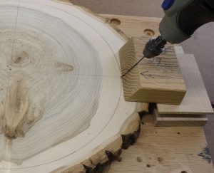

Cut the first circle. Mark a drilling point with an awl where the cutting line intersects one of the registration lines. Use a shop-made angle guide (see Tip below) and a #56 drill bit to drill a blade-entry hole, drilling directly toward the center of the blank. Note: The drilling angle depends upon the wood thickness: use 31˚ for wood 3/4″ (1.9cm) thick; use 33˚ for wood 11/16″ (1.7cm) thick; and use 35˚ for wood 5/8″ (1.6cm) thick. Tilt the left side of the saw table down to the same angle. Use a #7 blade to cut clockwise around the circle to complete the first ring. Mark the top of the blank to correspond to the top mark on the ring, placing it about 1″ (2.5cm) from the edge. This piece is the base.

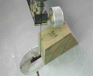

TIP: ANGLE GUIDES
Use an angle guide made from a scrap of wood to drill a hole at a specific angle. This guide can also be used to set your saw table to the desired angle for the cut.

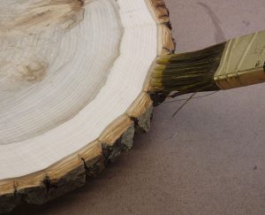

If you’re not using an additional base, move onto to finishing the tray. Apply shellac to the bark surrounding the first ring, and to the inner bark on the upper face. This will heighten the contrast between the bark and the wood. Sand the inner bark on the upper face lightly with 320-grit sandpaper, to reduce shine and remove any shellac from the wood. If you are applying a water-based or solvent-based finish, apply it to all areas of the tray, except the outer bark. Once dry, smooth the surface with 320-grit sandpaper. Apply additional coats as needed. Smooth the surface between coats with 320-grit sandpaper, 0000 steel wool, or a well-worn 4″ (10.2cm) 320-grit sanding mop; do not use steel wool with water-based finishes. If you’re using beeswax and mineral oil, apply it sparingly; let it dry for 15-30 minutes, then buff to a soft sheen. If more than one coat is required, wait 24 hours between each coat. I used three applications of beeswax and mineral oil for this bowl tray.

Another change from standard procedures is the use of glue size. The end grain faces of bowl rings cut from tree rounds are porous and absorb glue rapidly. Glue size, made by mixing water and glue in a 2:1 ratio, reduces their porosity and prevents weak, glue-starved joints. To use it, remove sanding dust from the gluing surfaces and apply the glue size with a brush. Let the pieces sit for a few minutes, then apply full-strength glue to one of the gluing surfaces. Clamp and remove squeeze-out as with any tray.

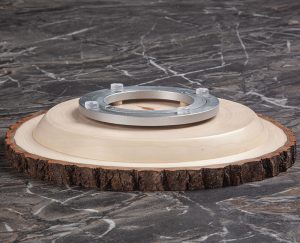

I added a rotating base that could be screwed directly into the underside of the tray with #8 flat-head wood screws, drilling and testing the fit before applying the finish. Intended primarily for movable displays, this mechanism, available online, consists of two concentric 1/2″ (1.3cm)-wide rings, each containing four rubber feet wedged into countersunk holes. To screw it to the tray, you must first remove the feet from the inner ring. This is most easily done by drilling through the feet from the countersunk side. Use the largest drill bit that will fit; mine was 1/6″ (4mm) in diameter. Once complete, center the base on the underside of the tray. The countersunk side of the small ring should be facing you; secure the ring with small pieces of double-sided tape to prevent movement as you mark the holes. To ensure accuracy, I marked the center of each hole by inserting a #10 screw into the hole and tapping it with a hammer to create the drilling point. Once the holes are marked, remove the base and drill pilot holes with a 3/32″ (2.4mm) brad-point bit, drilling halfway through the wood’s thickness.
Spacers
These are placed between the bottom of the tray and the rotating mechanism, allowing it to turn freely. Here are three options:
  • If you drilled completely through the rubber feet when removing them, you can now glue them back into place with CA glue. Once the glue has set, you can re-drill the holes, if needed.
  • Drill a hole with an 11/64″ (4mm)-dia. bit through a 2″ (5.1cm) length of 7/16″ (1.1cm)-dia. dowel. Cut four even slices from the dowel, each about 1/4″ (6mm) thick. They are secured by the screws when the mechanism is attached.
  • From a 1/4″ (6mm)-thick piece of wood similar in color to the tray, cut a circle that matches the outer diameter of the smaller ring. Mark and pre-drill pilot holes with the 11/64″ (4mm)-dia. bit. Place the circle between the mechanism and tray bottom, aligning pilot holes, when you attach the mechanism to the tray.
To determine screw length, measure the combined thickness of the mechanism and spacers and add half the thickness of the tray. Place the spacers over the pilot holes, position the mechanism on top, insert the screws and turn them in rotation just until tight.
