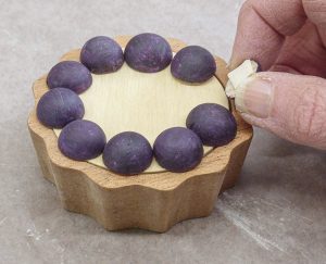

Blueberry or Cherry Tartlet
| Ten 9/16″ (15mm) painted wooden balls: five whole and nine halves
Lightly sand the drilled end of four of the balls with a sanding block or sanding tile to clean and flatten the gluing surface. With the lid on the tartlet shell, use tape loops to position the halves around the edge of the lid, extending them slightly over the edge. Use tape loops to position the four sanded balls in the center, sanded side against the lid. Remove the lid and place on wax paper. Glue the four center balls first. To do this, squeeze a small amount of CA glue on the wax paper. Remove one ball and its tape loop. Apply glue to the sanded bottom with a toothpick, and then return the ball to its original position. Press down until set. Repeat for the next three balls. Tweezers add extra control for placing round balls. Then, glue on the halves, one at a time, applying the glue to the underside with a toothpick. A small piece of dry paper towel at the end of a toothpick works well to remove excess glue. Glue the last ball into place on top of the center four. Finish the lid with a sealer coat of shellac and several coats of gloss spray lacquer, and then let dry fully. |

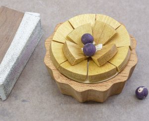

Pineapple-Blueberry Tartlet
| 12 pineapple wedges
Blueberries: Three 3/8″ (10mm) wooden balls, painted blue With the lid in place, tape eight wedges evenly around the circumference, extending them slightly over the edge of the lid. Remove the lid and place on wax paper. Squeeze a small amount of CA glue on the wax paper. Apply glue to the underside of each wedge and press it into place. When these wedges are set, position the remaining four in the center, sanding or cutting them to fit. Glue them into place. Sand the drilled side of the balls with a sanding tile or block to flatten the gluing surface. Tape then into position, and then glue into place. Finish the lid with a sealer coat of shellac and several coats of gloss spray lacquer, and then let dry fully. |

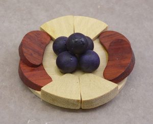

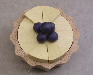

Orange-Pineapple-Blueberry Tartlet
| Six orange segments
Four pineapple wedges Blueberries: Five 15/32″ (12mm) balls, painted blue With the lid placed on wax paper, place a lid pattern on top and mark the center point with an awl. Flatten the drilled ends of four of the balls slightly by sanding. Tape them, sides touching, around the awl mark. Glue them into place, one at a time, then glue the fifth ball on top. Tape one pair of pineapple wedges on one side of the lid, and then another pair directly opposite. They should face the center and extend slightly over the edge of the lid. Tape two pairs of overlapping orange segments in the same manner, using the remaining two spaces. If more room is needed, sand the sides of the pineapple segments slightly. Position a third orange segment in front of each overlapping group to check the fit, and then remove it. Glue the pineapple wedges into place, and then the two sets of orange segments. Glue the third orange segment for each group into place. Finish the lid with a sealer coat of shellac and several coats of gloss spray lacquer, and then let dry fully. |

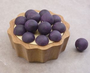

Plum Tartlet
| Plums: Four 13/16″ (20mm) balls painted purple. Cut three in half. Trim 1/16” (2mm) from the drilled side of the remaining ball to create a flat gluing surface.
Tape the whole ball into the center of the lid, and then tape the six halves evenly around it. Glue the whole ball into place first, followed by the halves. Finish the lid with a sealer coat of shellac and several coats of gloss spray lacquer, and then let dry fully. |
