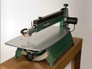

The Excalibur EX-30 is one of the largest saws on the market. The generous 30″ throat means you can cut projects up to 30″ long without using spiral blades. The EX-30 is also capable of cutting wood up to 2″ thick.
General International redesigned the EX-30 scroll saw using the same technology which debuted on the EX-21. The most significant change is that the EX-30 now features a tilting head instead of the traditional tilting table. Scrollers will also notice the Excalibur’s trademark purple color has been replaced with the traditional green historically associated with all General tools.
Tilting Head
The first thing that struck me about the EX-30 is how easy it is to square the blade with the table. With other saws, you tighten the table-locking screw enough that the table does not move, but loose enough that you can adjust the table with a well-placed rap. The rack-and-pinion system that controls the tilting head makes squaring the blade as easy as turning a knob.
On most saws, the angle marks that indicate the tilt of the table can’t be trusted for perfect accuracy. But that’s not the case with the EX-31. It features a springloaded cam that locks into precision-machined holes at most common angles. When I used the cam to lock the head at 0° (no tilt), the blade was perfectly square to the table. It took seconds to do a job that can take me several minutes with other saws.

The power switch and speed control are both conveniently located on the front of the scroll saw arm. The quick tension release is right above the blade-locking thumb screws.
Unfortunately, the blade-tensioning knob is on the back of the arm, and since that is more than 30″ away from the front of the saw, you need to stand up or lean quite a bit to adjust the blade tension. I prefer the tensioning system on the EX-21, where the tension control is located at the front of the arm.
