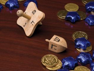

The Compound Dreidel
Fold the pattern along the dotted line. Apply spray adhesive to the pattern, align the fold with the corner of the blank, and press the pattern onto the blank. Cut along the pattern lines on one side. Wrap the blank with clear packaging tape and cut the second side. Use caution when cutting the thin stem on the top of the dreidel. Sand the piece lightly and add the letters to each side. You can use a woodburner, paint, a T-shirt transfer, or a marker. If you use a marker, seal the wood with varnish or shellac before drawing on the letters to prevent the ink from bleeding. Then apply another coat of shellac or varnish to protect the wood.
The Flat Dreidel
Transfer the pattern to the blank. Drill the 3/8″-diameter hole in the center and cut around the outside edges. Sand the piece and follow the suggestions above to add the letters. Sharpen one end of a 3/8″-diameter dowel with an eyeliner pencil sharpener to produce a blunt point or sand the point onto the dowel. Drill a 3/8″-diameter hole in a wood bead. Glue the bead to the un-sharpened end of the dowel. Place the dowel through the hole in the blank and glue it in place.
