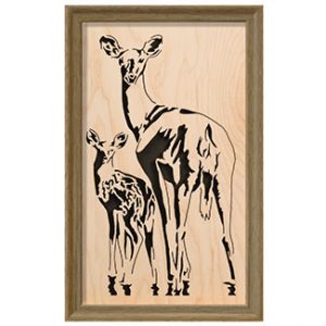

“Looking Back” Deer Portrait
Touching portrait of a doe and fawn captured in wood
By Charlie Dearing
As soon as I saw the photo this pattern is based on, I knew I had to recreate it in wood. It’s an iconic image of mother and child that transcends species.
Projects cut from thin plywood, such as this, should be stack cut. Stack cutting protects fragile fretwork bridges and speeds up production, giving you two projects in the time it takes to cut one. For more information on stack cutting, see Scroll Saw Basics.
Making the Portrait
Cut the blank or blanks to size. Secure the stack using double-sided tape or brads in waste areas. Attach the pattern to the blank with spray adhesive. Drill blade-entry holes and cut the fretwork, saving the cutout pieces whenever possible. After you finish cutting, replace the cutout pieces to support the fretwork while you sand everything smooth. Apply a clear spray finish and frame as desired.
