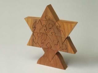

Finding a pattern suitable for those of the Jewish faith can sometimes be difficult. I designed this puzzle when I realized how many of my customers wanted Hannukah gifts. You can cut it from any wood, but as you probably know, I have a marked preference for hardwoods. I cut the one pictured here from cherry.
Because the Star is not interlocked into its base and only rests there, it is less stable than a completely interlocking puzzle. Start by attaching your pattern to the blank, using temporary bond spray adhesive or your method of choice.
