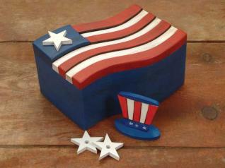

Celebrate our nation’s birthday with this simple patriotic scrolled box. By cutting each layer separately, you can make the box much deeper than if you glue all the pieces together before cutting or cut it out of a solid block of wood. Start by making several copies of the pattern—usually one per layer since the wood I used is too thick to stack cut.
