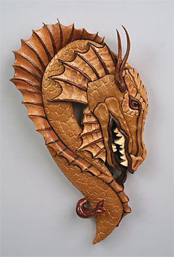

| A good photo of a Lora S. Irish intarsia design scrolled by Sam Willcox. The balance of shadow and highlight shows off the details of the project. Note the softness of the outer shadows that are cast by the piece. | |
| Digital cameras have a “white balance” setting in place to compensate for different lighting conditions. If you choose the wrong setting, the photos will take on an odd color. | |

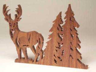

A slight change of angle adds great visual appeal to this deer fretwork project, a Lora S. Irish design, scrolled by Dave Penman.
| Here the project was shot from the front with only the on-board flash. The details are washed out and the project looks very flat, and not that interesting. Note the harsh, close shadow created by the flash. |

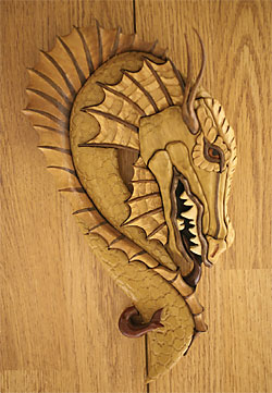

Background
| A busy background or one of similar texture and tone can totally upstage the subject of a photograph. |
Not only can textures and color be distracting, but countertops, cupboards and furnishings can draw attention away from the project. This photo also suffers from the glare created by the camera’s onboard flash unit. |
A good background for a photo doesn’t draw the eye away from the project.
The project should be the focal point of the photograph. The texture and lighting should focus on the scrolled work. That is why it is important to think about what is behind your project when taking a photo.
