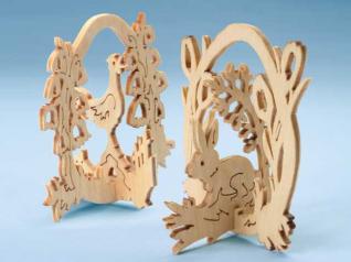

This set of interchangeable Easter ornaments will be a great addition to your spring decorating—and since they can be stack cut, they make ideal sale or gift items. They arent difficult to make, but they do require some careful and intricate scrolling. There are two egg patterns and three inserts for the eggs: a cute little duckling, a crowing rooster, and an Easter bunny. Make several sets to use for table decorations that can be sent home with your guests. You could also tie string through the top to decorate your Easter tree or to hang in a window—the traditional German practice. Because these ornaments are small, this is also a good project for using up small scraps of wood. This project will teach you about stack cutting, cutting “veins” or detail lines, and challenging interior fretwork.

Step 3: Cut the ornaments. Go slowly. If you plan to cut the veins, do this first. Next do the small interior cuts. Then do the larger interior cuts, and finally cut the exterior lines. There is a lot of fragile detail, so it is important that you plan your cutting. Take the rooster as an example. Start by cutting all of the interior cuts and veins. The base with the house and fence is not very fragile, so cut this part next. Then start working on the rooster. Carefully cut the detail around the head before cutting the narrow neck. Cut the feathers of the tail before cutting the rest of the tail. Finally, cut the rest of the body, and be very careful as you cut away the waste from both sides of the legs. Use this same strategy as you cut the other two inserts and as you cut the flower blossoms, leaves and grass on the eggs. Do the most fragile parts last, and try to leave waste wood to support the connective parts. I recommend that you cut the slots slightly undersize (see Step 5).

Step 5: Check the slots for proper fit. As needed, use a small flat file or scrolling file to enlarge the slots for a snug fit. Be very careful when pushing the parts together to avoid breaking these very fragile ornaments.
