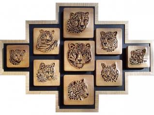

Carving on Fretwork Creates Lifelike Portrait
WILDCATS OF THE WORLD, featuring Dick's carved fretwork technique, took Best of Show in the SAW contest at the 2007 PA Scrollabration.
WILDCATS OF THE WORLD, featuring Dick’s carved fretwork technique, took Best of Show in the SAW contest at the 2007 PA Scrollabration.
3D Tiger leaps from the wood
I developed a new technique to bring fretwork portraits to life. This carved-fretwork technique combines traditional scrolling with basic relief-carving techniques. The combination brings the portraits to life with depth and dimension.
Creating carved fretwork is not difficult. The technique enhances the fine fretwork details already present in the scrollwork. By following simple steps, you can use a rotary power carver and a router to add unique texture to your fretwork projects. If you can do the scrollwork, I am confident you can also do the carving.
Realistic wildlife, especially big cats, is my favorite subject, but the technique can easily be adapted to a wide variety of fretwork projects.
