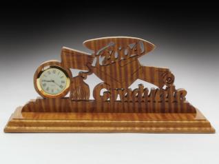

Take a careful look at the MATERIALS & TOOLS list for this project. You won’t see any wood glue listed because none is required. It’s not a mistake. It’s glueless!
A woodworking friend saw one of my graduation plaques and carefully inspected it. Noticing some splintering around the attachment points, he said he could show me a trick that would give me a clean and secure attachment. In just a few minutes, we had taken apart an unglued project, and then he showed me the secret: countersinking. With this simple technique, the two pieces fit together like a hand in a glove. I was amazed and completely sold on this method. Don’t throw away your woodworkers glue, but you won’t need it to make this commemorative plaque, presented just in time to congratulate your favorite graduate!

Countersinking is an effective means of attaching parts without glue. From left to right you’ll see a countersink with a screw, an open countersink and a slightly countersunk hole used in this project.

Step 10: Slightly countersink holes on the top of the base and the holes in the upright. By slightly countersinking these holes, the upright will fit tight to the base without splintering. Attach the base to the upright with the two brass screws.
Step 11: Dye the base and the upright with the honey amber dye or color of choice. I found that the dye works best to show the grain of the curly maple. Then I applied two coats of lacquer. ALWAYS use lacquer in a well-ventilated area away from furnaces and water heaters. Before applying the final lacquer, sign the bottom of the base.
Step 12: Apply the felt feet, then stand back and admire your project.
