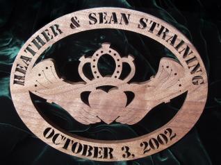

St. Patrick’s Day is coming, and here’s a project that can turn the day into a romantic one for you and your significant other. Present him or her a token of your affection: a wooden wedding anniversary plaque that has the look of a Claddagh ring.
Be sure the coast is clear when you’re working on this project and that you’ve got a good hiding place to put it. Then, you’ll be able to enjoy your spouse’s surprised look when you hand over the finished plaque.

Step 1: Using 180-grit sandpaper, prepare the wood by finish sanding it before applying the pattern. Sanding the wood now is easier than sanding the delicate parts after the cutting has been completed.
Step 2: Apply the Claddagh pattern to the board with temporary bond spray adhesive.
Step 3: Drill the blade entry holes into the glove and crown using a 1/8″ bit. The glove holes on the line ends should be drilled with a 1/16″ bit. I like using a moto-tool to drill the small starting holes because it is easier than trying to move the wood around on the drill press.Great Book of Celtic Patterns
Step 4: Use a #2 blade and begin cutting the inside fret areas first. I normally cut the smallest areas first, leaving the larger areas to add support. Be careful where you grab the wood as you are making cuts. There are many delicate parts that could be broken. I try to hold the wood with my fingers on the outside edges of the board so I don’t break the delicate parts.
Step 5: Now, it’s time to cut the letters, numbers and comma. Be sure you have an entry hole for each piece of the letters and numbers and one Celtic Frames & Borders – Book w/ CDfor the comma. It’s crucial that the letters and numbers look as identical as possible so take occasional breaks during this part of the project. Cut the outside of the plaque after all of the inside fret cuts are completed.
Step 6:  Finish sand the project with 220-grit sandpaper. The insides of the cutouts do not need to be sanded because the blade leaves these surfaces smooth.
Step 7: Wipe the wood with a tack cloth to remove any dust. I finished this piece with two coats of Deft Gloss Clear Wood Finish. I prefer to use the spray version of this product.
