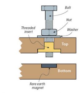

Cut the plywood or MDF to size. The boards must be flat and the ends must be parallel. Drill the holes as indicated in the templates on page 14. Glue rare earth magnets into the holes in the bottom board, and install threaded inserts into the under side of the top board. Make sure the boards sit flush against each other. Then, refer to the drawing and install the bolts, nuts, and washers from the top side of the top board. Do not tighten the nuts against the board. Finally, install the hinges across the ends opposite the other hardware.

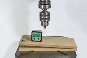

Zero a digital angle guide on the closed jig on the drill press table. Slowly rotate the back bolt to tilt the jig until the angle guide reaches the desired setting. Screw the front bolt in until it just touches the magnet, and then finger-tighten the nuts down against the top board to lock the angle.

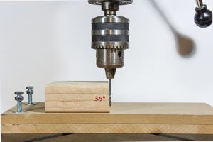

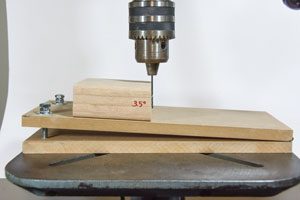

Use a scroll saw to cut the ends of several pieces of scrap at common angles; mark each block with its angle. Place the closed jig on the table and hold it in place with a fence or two pieces of double-sided tape. Place an angled block on the jig near the drill bit. Slowly rotate the back bolt to tilt the jig until the drill bit is parallel with the angled block. Screw the front bolt in until it just touches the magnet, and then finger-tighten the nuts down against the top board.
