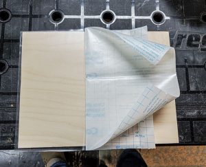

After selecting your wood, apply the pattern. You can attach it to Con-Tact® brand clear removable shelf paper, as it’s easy to remove after cutting. You could also cover the blank with blue painter’s tape and attach the pattern to the tape with spray adhesive. The last thing you want is a pattern that won’t come off, as this interferes with sanding and finishing and could result in breaks down the road.

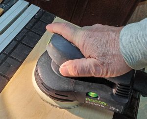

Pre-Sand Your Blanks
You will have difficulty sanding without damage after the piece is completely cut. So, consider pre-sanding your blanks to 320-grit and then removing sanding dust with a clean tack cloth.

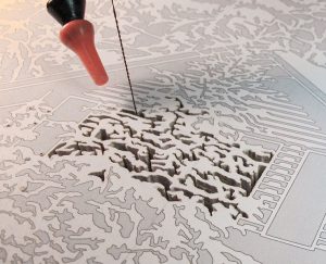

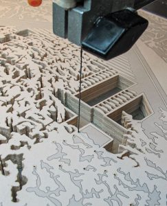

Instead of drilling all the blade-entry holes at once, try drilling holes in approximately 15 to 20 cutouts at a time, starting at the center. Cutting in increments makes the piece feel more manageable and maintains stability for a longer period of time.
Pick the Right Blade

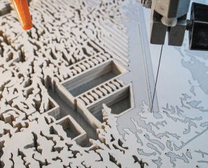

Use a high-tooth-count blade, such as #2/0 at 28 TPI (teeth per inch), for more precise, controlled cutting. If the piece contains many irregularly shaped holes, consider using a spiral blade. Spiral blades leave a rougher edge and more fuzzies, but can save you time and effort, especially on difficult turns. For long, straight cuts, a straight blade is ideal. Note: If the design has a mixture of irregular cuts and long, straight cuts, you may need to switch blade types partway through the project. Practice the spiral blade before you commit to using it in a complex piece.

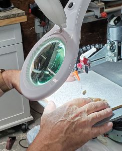

Grab Your Gear

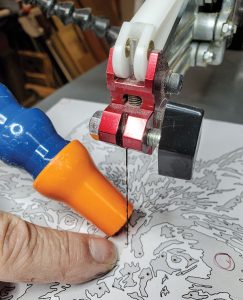

With intricate projects, a magnifier with good lighting can be a huge help. A headlamp can also be useful in fine detail work.

Cutting from the center out adds more stability to the piece; it will also keep the project more centered on your scroll saw table, supporting the most delicate sections and reducing the chance of breakage.

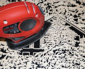

Sand as You Go
After cutting each section of 15 to 20 cutouts (or less, if it makes sense for your project), flip the piece over. Then sand lightly with a palm sander or sanding block to remove most fuzzies. Hold the sander as flat as possible so as not to damage the workpiece; little cutouts, like hangnails, are easy to catch and tear. Sanding this way will make for less cleanup after the piece is complete.

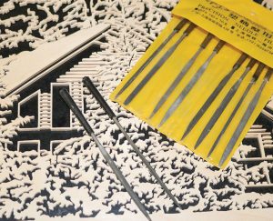

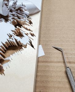

Once your cuts are complete, remove the pattern very carefully to avoid snapping any pieces. Use a dental pick to get under the pattern and needle files for the insides of small frets. Heavy-duty sanders are not welcome at this stage, as they could ruin hours of painstaking work. To minimize wear on delicate bridges, consider applying a spray finish rather than a brush-on. Clear spray lacquer works well. For a more colorful look, consider a spray paint-and-primer combo. If you plan to display the piece behind glass, a satin finish may be preferable to gloss; if you’re leaving it plain, gloss or semigloss work well.
