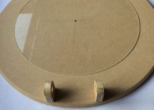

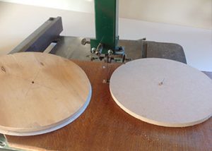

1: Cut the perimeter of the base and frame. I use a band saw with a simple circle cutting jig, but it can be cut with a scroll saw. Then, drill a blade-entry hole and cut the inside of the frame. Use the inner dotted line on the frame pattern to cut the clear acrylic plastic for the window. Leave the protective film on the acrylic plastic until the final assembly.

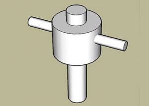

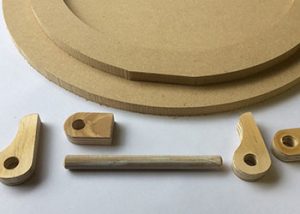

2: Drill the indicated holes and cut the hinge uprights. Then, drill the required holes and cut the hinge arms and the locking tabs. Cut the locking tab dowels to length, and drill as indicated on the pattern. Cut the locking pin centers, the hinge pin, and locking nut toggles to the length listed in the materials list.

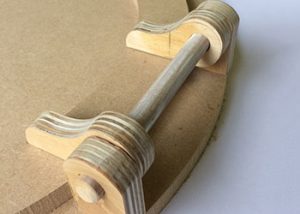

3: Sand the hinge uprights and hinge arms. Dry-assemble the hinge uprights, hinge pin, and hinge arms. Check the fit and mark the position.

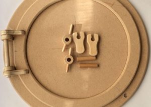

4: Sand everything else. Round the edges of the small pieces with sandpaper. Dry assemble the frame, locking tab assemblies, and hinge assemblies to check the fit.

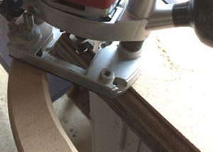

5: Round the sharp corners. Use a router with a roundover bit to round the outer edges of the base and frame. Then, use the router to cut the rabbet for the acrylic plastic on the inside of the frame.
6: Glue and screw the hinge uprights to the base. Drill 1/16″ (2mm)-diameter pilot holes and use two #8 x 1-3/16″ (30mm)-long wood screws to attach the hinge uprights to the base.

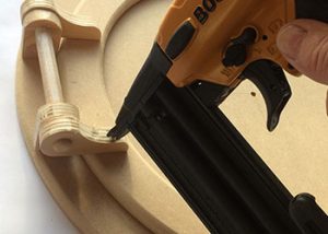

7: Center the frame on the base. Insert the hinge pin through the uprights and put the hinge arms on each end. Position the arm on the frame, and glue and pin nail them in place. Make sure you don’t drive the pins into the base.

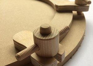

8: Glue and pin nail the locking assemblies together. Insert them through the locking tabs into the holes in the base.
9: Glue and pin nail the locking tabs to the frame. Do not nail through the frame into the base. Glue the locking tabs to the locking tabs, but do not glue them into the holes in the base. They help hold the frame in place, but must come out to change the photo.
