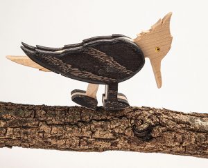

In addition to their striking features, woodpeckers are notorious for, well, pecking wood. They use their long beaks to peck, drill, and drum wood for hours, relying on their strong tail feathers to support them as they cling to a tree trunk or branch. They also have two back toes to lean on! My woodpecker ramp walker does not have helpful toes, but it does have movable legs that will get it from point A to point B. All this dynamic toy needs is gravity to get moving.

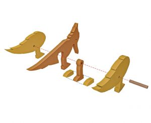

Cut the pieces. Then drill the 1/4″ (6mm)-dia. dowel holes while the outer pieces are stacked. Use an awl to mark the center of the swinging leg piece. Remove the patterns and sand each piece with an orbital sander, lightly softening the sharp edges on all sides except the ones that will be glued; these should stay flat. Take extra care to smooth the swinging leg piece, as it should be able to move without friction. Drill a 17/64″ (7mm)-dia. hole through the awl mark on the swinging leg piece. Stack the three body pieces, making sure the edges are flush.
Glue and clamp one side onto the central body piece, keeping glue out of the area where the swinging leg will go. Once the glue is cured, dry-fit the rest of pieces together with clamps. You can dry-fit a dowel into the hole to help with alignment. By clamping the two sides during the dry fit, you simulate the conditions of the actual glue-up, and can easily sand the swinging leg further if it binds when pressure is applied. The legs will form a slight curvature when side-by-side to allow for rocking. Note: If the legs do not sit at the same level, the bird will not walk properly. Refer to the exploded drawing below.
When you are satisfied with the fit, glue the dowel to one side, leaving the back leg unglued and free to swing. Then glue and clamp the second body side in place, applying glue to this side of the dowel, as well. Cut off the excess dowel and sand both sides smooth on a belt sander. Soften all body edges further with the orbital sander, and then hand-sand the edges, moving up progressively through the grits to 320. Remove dust with a tack cloth.
Woodpecker Ramp Walker Assembly Drawing

Apply a finish. If you chose a material without a pronounced or decorative grain, such as MDF or pine, get creative with different colors; you could paint on thinned acrylics, and then apply a clear lacquer once the paints have dried. If you chose rich hardwoods, a natural finish (such as clear satin lacquer) is best. Alternately, you could leave the toy unfinished and let a child’s imagination do the rest, encouraging them to experiment with watercolors, glitter, felt pens, or crayons.
For a different look, use stained hardwoods.
Test Run
To test the project, you will need a ramp. I used a wide wood plank, propped up on one end. Position the walker at the top of the slope and give it a tap to get it to rock. Adjust the angle as needed; if it’s too shallow, the walker won’t move, but if it’s too steep, the toy will fall on its beak.
