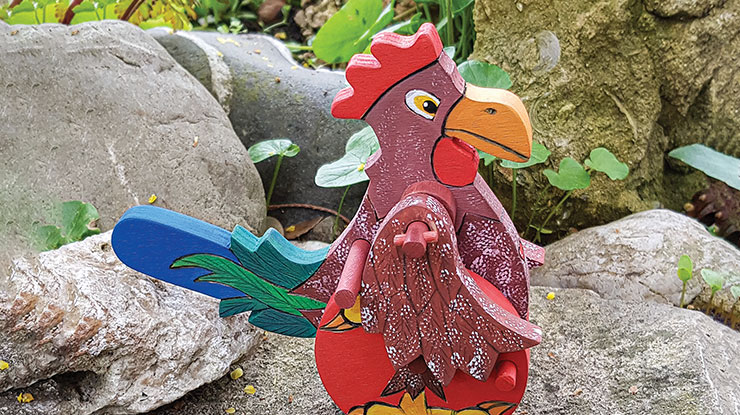

While cleaning a friend’s house one day, I discovered a funny chicken toy. I thought it would be the perfect gift for a friend’s daughter, so I recreated the toy and made it a rooster. My friend’s daughter was very happy about it. I wish you just as much joy with your wheely rooster.

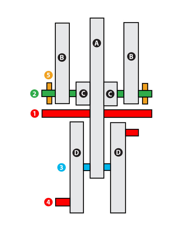

Refer to the assembly drawing at right to assemble the project. Put a little glue in the top two holes of the body and insert the shoulder bar and wing lock. The ends of the dowels must protrude equally on both sides. Then slide the spacers onto both ends of the shoulder bar with the rounded sides of the spacers pointing upward. Slide the wings onto the shoulder bar, making sure they can move freely.
Glue the wing brackets (labeled #5) into the drilled holes in the ends of the shoulder bar (labeled #2). Dab some glue into the holes near the perimeter of the wheels and insert the cams (labeled #4).
Glue a wheel to the axle (labeled #3). Then, push the axle through the hole and glue the other wheel to the axle, leaving some room for free movement. The wheel cams must sit opposite each other, and the axle must move easily. Now your rolling rooster with flapping wings is complete!
