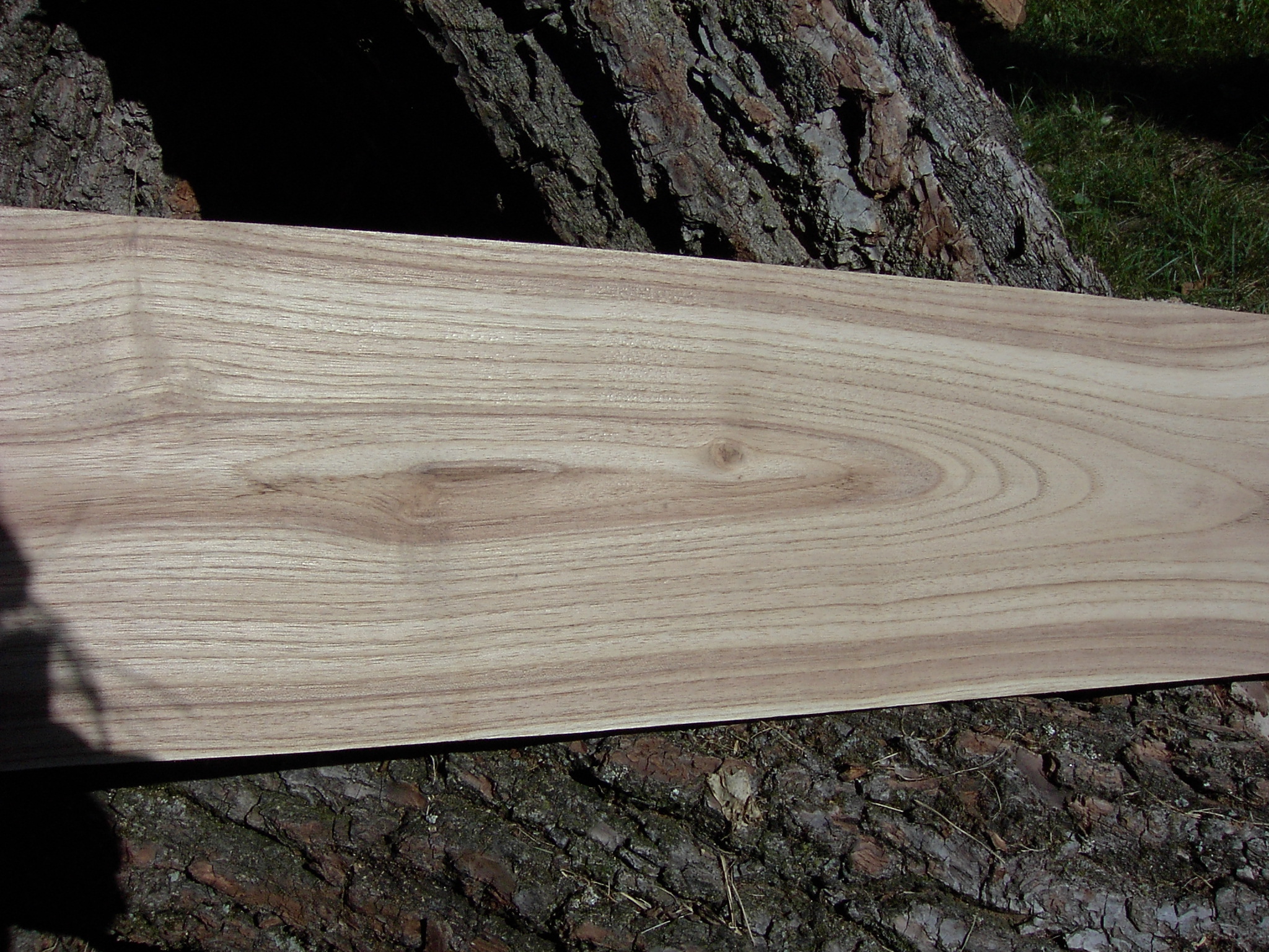

Mimosa, a popular ornamental tree that sports fern-like leaves, makes a surprisingly good wood for scrolling. The light-colored wood is highlighted by a distinct dark grain that lends an exotic look to many scroll saw projects.

As far as I know, mimosa boards are not commercially available, so you will need to cut and dry your own lumber. I obtained my stock when helping a friend remove a dead mimosa tree. I originally intended to burn the tree as firewood, but changed my mind when I noticed the attractive grain pattern.
Because of the way the tree limbs arch out from the trunk, the wood has a fair amount of stress in it. Be careful when ripping mimosa into boards, as some of the pieces may bow or even split. Smaller branches can be cut on a table saw, but for the trunks and larger branches, I use a band saw.

While mimosa and pine are similar in hardness, mimosa cuts better because it lacks the troublesome sap and pitch of pine. The contrasting colors of grain make mimosa suitable for fretwork and intarsia. I recommend 1/4″ or thicker stock for fretwork to minimize breakouts.
Mimosa can be fuzzier than other hardwoods and reacts to sanding like most softer hardwoods, such as basswood. I sand the wood with progressively finer sandpaper up to 220 grit.
