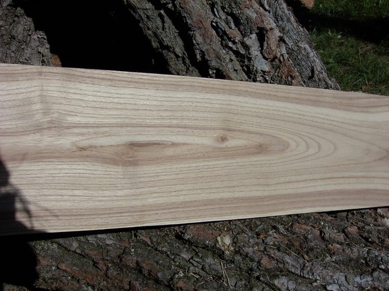

Osage orange is readily recognized by its distinct yellow color. Unfortunately, the vibrant color usually turns a light brown when the wood is exposed to oxygen and sunlight. You can take steps to preserve or at least prolong the vivid yellow color, and despite being a relatively hard wood, it’s a joy to cut on the scroll saw.
A relative of the mulberry tree, Osage orange, also known as bodark, horse apple, and bois d’arc, is native to the central United States, but it has been planted throughout the United States and Canada as a hedge row or wind break tree. Most people consider it a shrub, since it tends to stay small, but Osage orange trees can grow up to 60′ tall. The sapwood is usually white.

Osage orange is rated at 2040 on the Janka hardness scale. This is close to the tropical hardwood goncalo alves (2160). It is one of the hardest domestic hardwoods, even harder than hickory (1820).
The design I cut required me to drill 251 blade-entry holes. I didn’t break a single #63 drill bit. By contrast, when I cut Brazilian cherry, I am lucky to drill 30 holes without breaking a bit.
I was surprised how easy the 1/4″-thick wood was to cut on the scroll saw. I have heard horror stories about how difficult Osage orange is to cut, but I found that it cut well with the #1 reverse-tooth blades that I use for 90% of my portraits. I actually had to reduce the speed of my saw so I could control it. It is a bit tougher to cut than mahogany, but much easier than Brazilian cherry.
The hard, straight grain makes it an ideal wood for cutting intricate portraits. I was able to cut the entire portrait without any breakage. While the wood is hard, it sands and shapes well, which makes it a good choice for intarsia artists.
