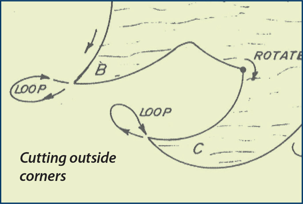

Tween-Graphic-1• Cutting outside corners (tips of cat’s ears): Show your student how to cut past the corner and loop around in the waste area to approach the next side of the pattern.

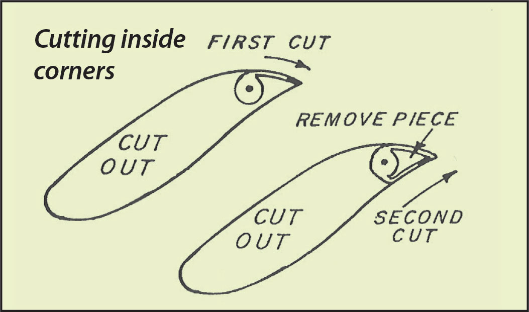

• Cutting inside corners (between dog’s tail and leg or cat’s front legs): Show your student how to cut up to the corner from one direction, back out, and cut up to the corner from the second direction. If necessary, make a third cut to remove the piece.

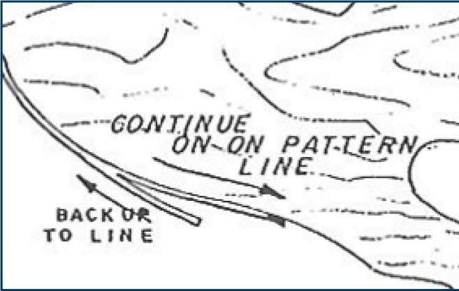

• Cutting away from the line into the waste: Back the blade to the place where it left the line and continue forward on the line.

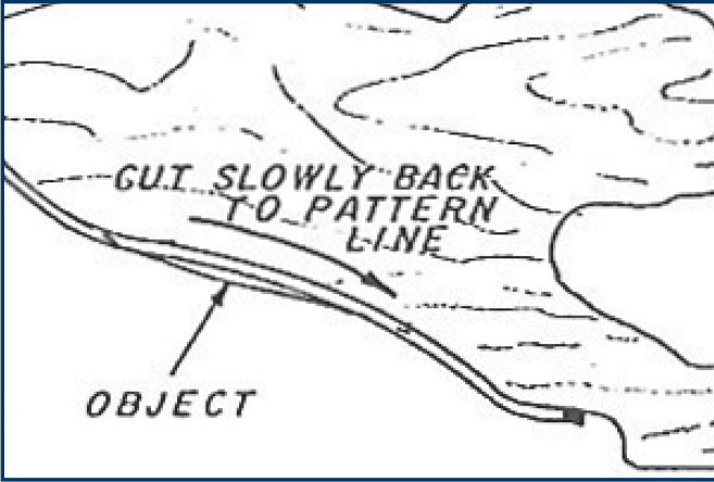

• Cutting away from the line into the project: Gradually taper the cut back to the line, making a gentle curve.
