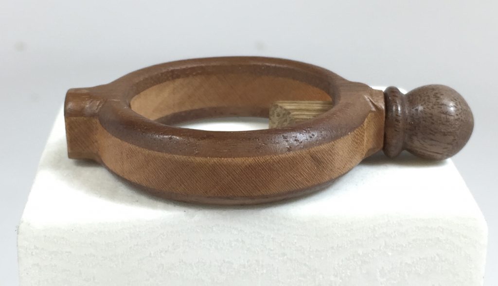

This clock part was cut from shop-made hardwood plywood, which gives it strength, durability, and an attractive appearance.

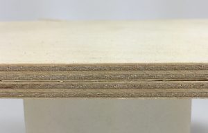

Alternating the grain direction in the layers makes plywood strong, but gives it a striped appearance that can be unattractive in some projects.
Despite its advantages, there are some problems with plywood. The different layers cause the edges of most plywood to look striped, which can be unattractive on some projects. Some plywood may sandwich softer, lower-quality wood between veneers of better wood. These softer layers can separate if you put enough pressure on them. Often, hardwood plywood hides medium-density fiberboard (MDF) between two layers of attractive veneer to reduce both cost and the layered look. However, MDF is not as strong as layers of wood and will separate or crumble with pressure. As a result, most commercial plywood is not suitable for any project that requires durability, such as gears, cams, drums, and other parts for gear clocks, gadgets, and animated gizmos.

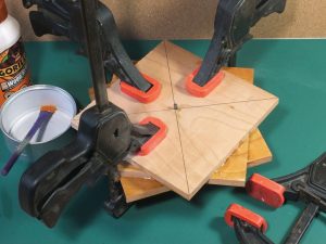

Gizmo designer John Hutchinson makes his own plywood for durability. Here he glues up three 1/4″ (6mm) pieces.
Tips for Making Plywood
• Choose thin pieces of wood of a similar size. Make sure all of the pieces are flat, spread wood glue evenly on the mating surfaces, and rotate the grain direction of each piece as you layer them together. John rotates the grain direction of each of his layers 45°; Rolf rotates the grain direction of each layer 90°. Use clamps and clamping boards, a bowl press, or a veneer press to secure the pieces until the glue dries.
