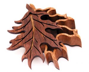

This box reminds me of the flutter of leaves falling to the ground in the fall. Like many of my designs, this box draws its inspiration from nature, in particular, the leaf of a red oak tree. To develop this pattern, I photocopied a well-proportioned leaf from my backyard tree. Then, with a sheet of tracing paper over the copy, I refined and revised the pattern into a smooth distinctive shape. The inside veins of the leaf are reminiscent of a tree themselves, and give a nice suggestion of the whole concept of a red oak tree.

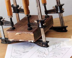

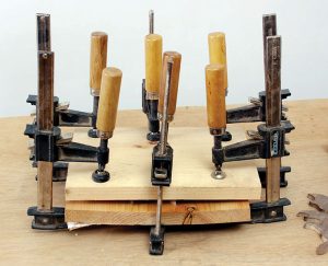

Step 1: Assemble the stack. Secure the 1/4″ (6.4mm)-thick  bottom and lid blanks on opposite sides of the 1 1/2″ (3.8cm)-thick box sides blank with double-sided tape. To make sure the tape bonds securely, clamp the stack together for at least five minutes. Cover the bottom of the blank with clear packaging tape. Attach pattern A to the stack with spray adhesive.

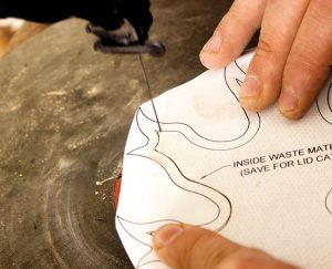

Step 2: Cut the perimeter. Use a blade designed for cutting thick wood, such an Olson thick-wood blade. Start at the stem and cut around the perimeter of the box. Cut slow and make sure the blade remains square to the table.

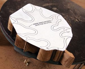

Step 3: Separate the stack. Use a sharpened putty knife to separate the three layers. Attach pattern B to the box sides blank with spray adhesive. Hold the piece up to a window or lamp so you can see the silhouette of the box against the lines of the pattern. Align the points on the pattern with the points on the box sides blank.

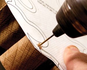

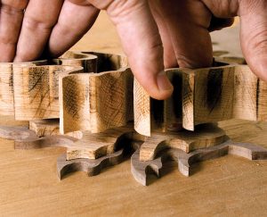

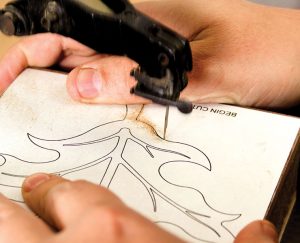

Step 4: Cut the box body. Drill a blade-entry hole where indicated on the pattern. Use the smallest drill bit your blade will allow. Cut slowly along the inside pattern line. Make sure the blade does not bulge or shift out of square. The waste section is used for the lid backer, so keep the waste section whole.

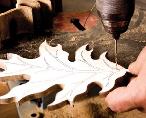

Step 5: Cut the lid. Drill a blade-entry hole and cut the vein details on the lid. Be careful as these cuts may cause the lid to become fragile. We will strengthen the lid with a backing board.

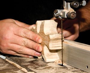

Step 6: Cut the lid backing. Set the band saw fence to make a 3/16″ (5mm)-thick slice. Rip a slice from the waste wood cut in step 4. Cut slowly and keep the wood pressed down to the table and against the fence. Alternatively, use a hand saw to cut off a 3/16″ (5mm)-thick slice.

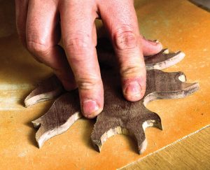

Step 7: Sand the pieces. Attach a sheet of sandpaper to your workbench with double-sided tape. Gently sand both sides of the bottom, the lid, and the lid liner. The sandpaper attached to the flat surface minimizes the risk of rounding over the edges of the blanks. Smooth the inside of the box sides with sandpaper. Work progressively through the grits.
