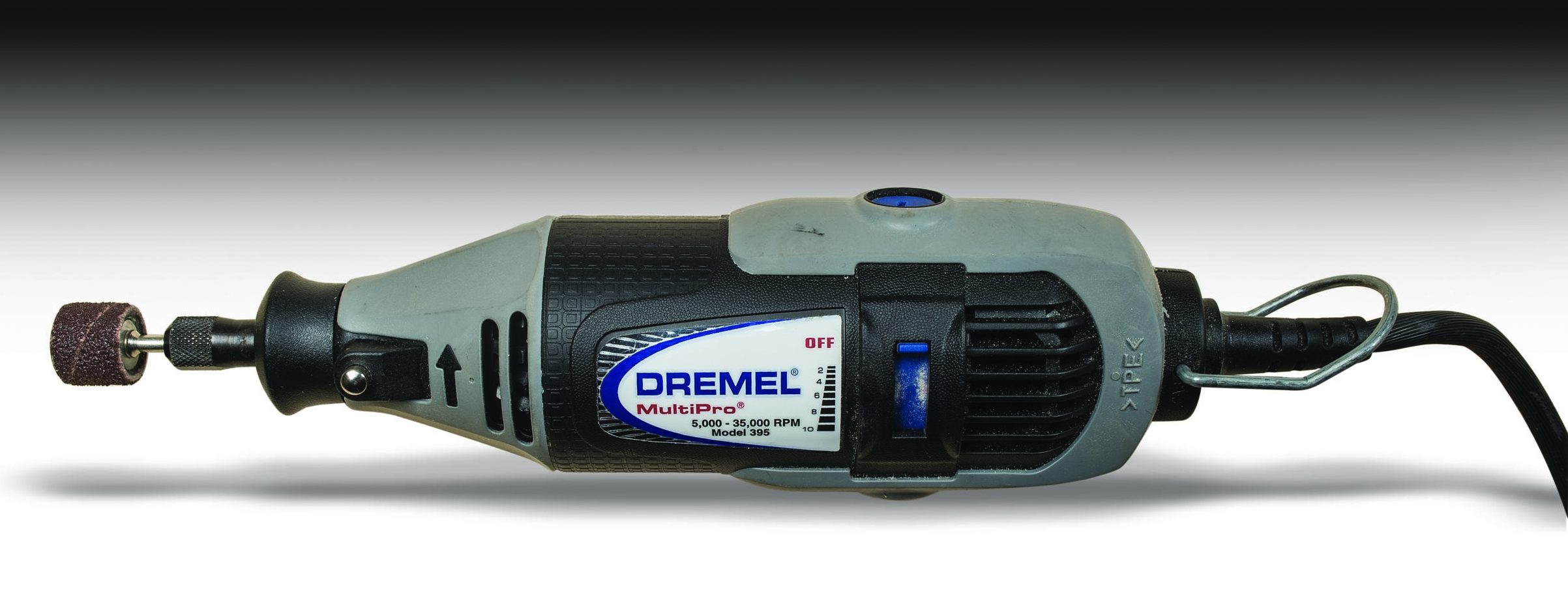

Choosing a Rotary Tool
Rotary tools range from low torque, high speed tools, to powerful motors hooked to flexible shafts, to high-speed grinders that are similar to dental drills. A low-torque tool, like a Dremel, and basic bits cost less than $100 and can be found in home-improvement stores. The more powerful machines cost $150 and up for just the tool and are usually only available at woodworking stores or by mail/online order.
Cordless and corded tools are available. I think the corded tools are easier to maneuver because they tend to be smaller (the battery pack adds length to cordless tools), but you do need to deal with the cord.
Any tool you buy will work. The more powerful the tool, the more expensive it is. For basic shaping (such as the work on the log book), you don’t need a lot of power or torque. To rough out intarsia pieces in a reasonable amount of time, however, you need a more powerful tool.
Once you get the feel for power carving, you may decide to upgrade your equipment. But if you’re a scroller at heart and just want to add some texture and shaping to your pieces, you don’t need expensive tools.

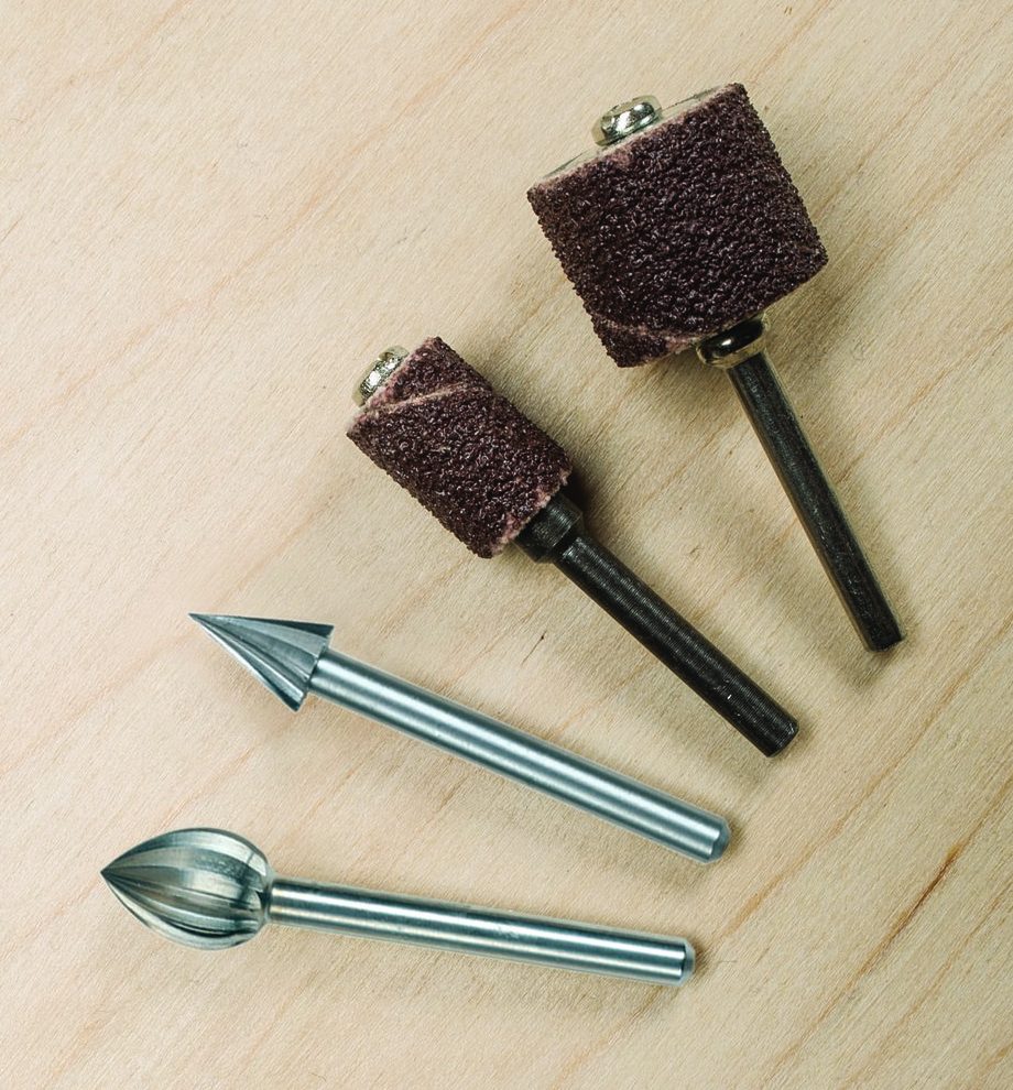

I suggest that beginners buy four bits: sanding drums in two sizes and cone-shaped and flame-shaped high-speed steel cutters. You can carve and shape most projects with just these bits.
Sanding Drums: Sanding drums are the workhorses for beginning carvers. You can choose the speed of the wood removal based on the grit of the sanding band. Choose a coarse-grit drum for fast wood removal and a finer-grit band for slower wood removal and a smoother surface. The 1/2″ (13mm)-diameter drum is good for most work, but you may need to switch to a 1/4″ (6mm)-diameter drum for small areas. Use the corner of the drum to get into tight crevices and the middle of the drum for open areas.
High-Speed Steel Cutters: High-speed steel cutters actually cut (carve) rather than sand. They can be more difficult to control than sanders, but they allow you to carve textures and fit into the tightest spots.
The cone-shaped bit has the sharpest point and fits into the tightest areas but, due to the shape of the cone, it doesn’t carve curved shapes into flat surfaces well. The flame-shaped bit has a point that fits into most areas, but also has rounded sides that allow you to carve curved shapes into flat surfaces.
As these bits get dull, they start to burn the wood. The bits are inexpensive enough that you can buy both and then replace them rather than attempt to sharpen them. With heavy use, the bits usually last a month, but their longevity depends on how you use them and the density of the wood you’re carving.
Although many bits are available, flame- and cone-shaped high-speed steel cutters and two sizes of sanding drums will give you the capabilities to get started.
