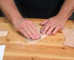

Step 1: Resaw the wood for the frames. Make the pieces the same thickness as the lenses. Cut the pieces to size and sand them smooth. I use three pieces for the frames and two to three pieces for the temples, depending on how thick you want the temples to be.

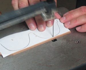

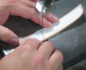

Step 2: Stack the three frame pieces together and secure with tape.  (See page 70 for stacking instructions.) Attach the pattern to the top and cut the perimeter of the pattern with a scroll saw. Separate the stack but don’t remove the pattern.
Step 3: Trace the lenses onto the middle layer. Drill blade-entry holes and cut the lens openings. The lenses should fit inside the openings with a little wiggle room around them.

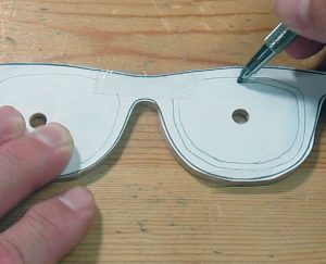

Step 4: Secure the two remaining frame blanks together. Trace the lenses onto the pattern, and then draw another line about 1/8″ (3mm) inside that line. The openings in the front and back frame pieces need to be smaller to hold the lenses in place. Cut the openings and sand them smooth.

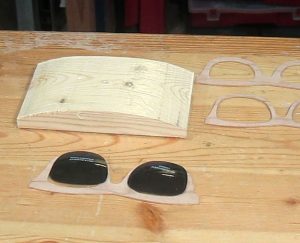

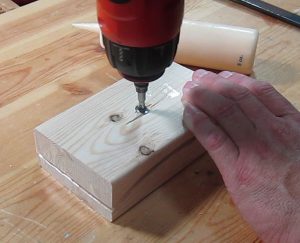

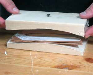

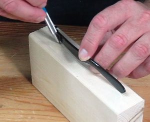

Step 5: Trace the arc from an old pair of sunglasses onto a piece of 2×4. Cut the 2×4 along this line. Drive a long screw through the 2×4 below where you expect the nosepieces to be, and then remove the screw. Cover the inside of the form with packaging tape so the form will not stick to the frames.

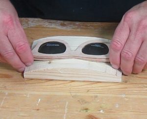

Step 6: Spread a thin layer of wood glue on the bottom frame piece and place it on the form. Avoid using too much glue. Align the middle piece with the bottom piece. Set the lenses in place.

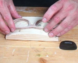

Step 7: Apply a thin layer of glue to the bottom of the top piece and place it in position. Position the stack on the form so the screw hole is in the middle of the frame below the nosepiece.
Step 8: Carefully position the top of the form on the stack. Make sure the screw is lined up with the screw hole in the bottom of the form. Screw it down slowly to bend the frames into shape, making sure the frame pieces do not slip out of place. This step requires patience. Secure the form with clamps.

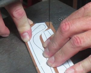

Step 10: Stack and secure the blanks for the temples. Attach the patterns to the top. Cut around the temple pieces, but leave excess around them at this time. Separate the stacks.

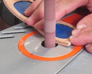

Step 13: Cover the lenses with blue painter’s tape. Sand and shape the frames and temples. Use a rotary tool with a sanding drum.

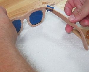

Step 14: Use hinges to attach the temples to the front frames. I use epoxy to attach spring hinges cut from metal reading glasses, or you can use any eyeglass hinges. Make sure the temples are in the correct position and the sunglasses lay flat on the table during glue up. Do not glue the hinges shut. Apply mineral oil or a beeswax finish; some other finishes can irritate the skin.
