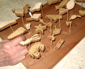

Step 5: Finish the puzzle. Drill toothpick-sized holes in a piece of scrap plywood. Dip each puzzle piece in finish, wipe it with a lint-free rag, and place a toothpick in the eye hole. Insert the toothpick in a hole in the scrap plywood and allow the pieces to dry. Use a foam brush to apply finish to the puzzle tray and let it dry.

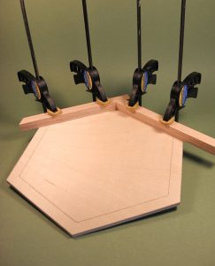

To make the tray bottom, trace the dashed lines from the pattern onto 1/4″ x 10″ x 10″ (6mm x 25.4cm x 25.4cm) Baltic birch plywood and cut along the perimeter only. Using 1/2″ (1.3cm)-thick hardwood and a table saw, cut six strips, each 1/2″ (1.3cm) wide by 6″ (15.2cm) long. Cut one end of each strip at a 60° angle.
Clamp (do not glue) the first strip to the tray bottom, aligning the strip with the inside traced line so it overlaps the edges of the tray bottom. Position the angled cut on the second strip against the first strip and align the strip with the traced guidelines. Apply glue to the second strip and clamp it in place until the glue dries. Align and glue the remaining strips one at a time, drying in between, until all are glued. Unclamp and remove the first strip, apply glue, and clamp it until dry.
After the glue is dry on the last strip, use a band saw or scroll saw to cut off the overhanging strips. Sand the perimeter and joints.
