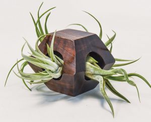

Our editorial assistant, Kaylee, loved this project so much that she made her own air plant holder from a piece of walnut.
